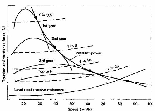

There's a much simpler way to do this. Optimum shift point is where the power the engine will be making in the new gear is the same as the power will be making in the old gear, so you'll be shifting after the power peak, but in a place where the new gear will be before the power peak. This will maximize the average horsepower, and thus the acceleration.

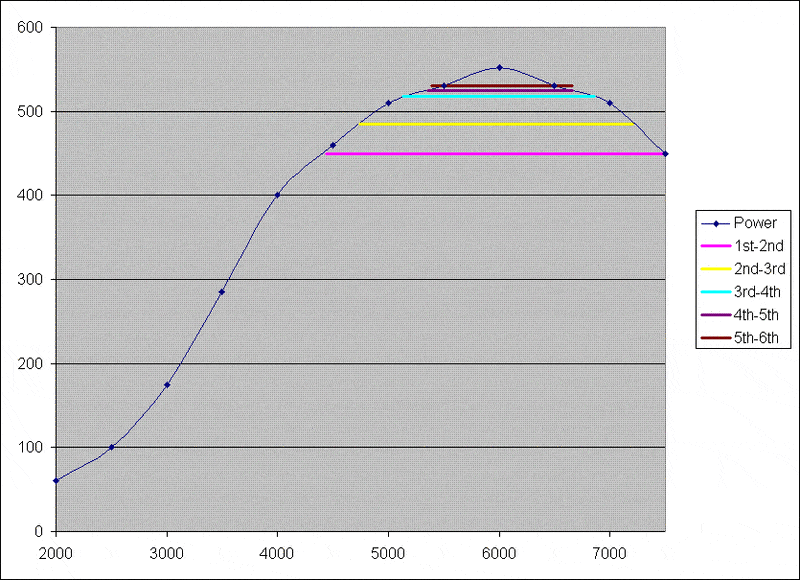

True, but using the power curve and looking for shift points such that power in the new gear is the same as power in the old gear is one of the easiest ways to find optimal shift points. You can definitely achieve the same thing just by looking at tractive force too though (and very nearly as easily).
I quite agree. But when selecting high and low RPM points with equal power, the constant of proportionality can be allowed to cancel.
RPM * torque is sufficient to find those points, no matter what data units are available.

I learned you should aim to keep the engine between peak HP (at the top end) and peak Torque (at the low end)... It's quite rare to ever go above the engine's peak RPM for max acceleration, and usually the torque is declining very quickly at that point, and you're better off with the 'penalty' of a higher gear ratio but more engine torque.
Using power is futile (more on that later). Just generate a set of output torque curves for each gear and overlay them. Your shift points may be determined by two factors: First, you run out of RPM so you have to shift, and second, output torque in the current gear falls below output torque in the next gear.

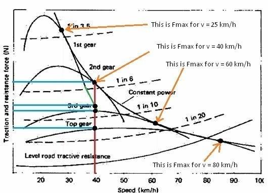

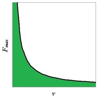

Let's take a vehicle powered with an engine (any type) that is transmitting its power through the wheels. What is the maximum force transmitted by the wheels, assuming no friction limit?
First, what do we know about this vehicle? We know it has an engine that produces power and that power cannot be unlimited: It has a maximum power (All engine/motor are defined by their power). We also know that the velocity of the car will change. Now, thanks to the concept of power (Thank you, Mr. Watt!), we can find the maximum force the engine can produce at the wheels:

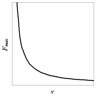

[tex]F_{max} = \frac{P_{max}}{v}[/tex]
Which gives in graph form:
As you can see, we now know the maximum tractive force the car can produce at any speed, no matter the radius of the wheels, the gear ratios (if any), the engine torque or RPM, even the engine's type (piston, turbine, electric motor, etc.).

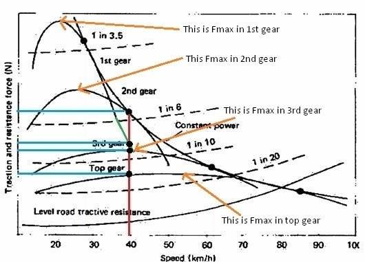

As you already mentioned, this available force can be translated into acceleration, if you know the vehicle mass (which is also a fundamental value of your vehicle).
The only thing left to the vehicle designer is to select the appropriate method to make sure that the maximum power will be available at any speed (For example, using a gearbox with a piston engine like in the figure below. Note that - even though each curve correspond to the torque curve of the engine - the «Constant power» curve meets the maximum power in each gear).
From that simple concept of power, I can determine what type of engine will be needed to achieve the acceleration curve I desired, and the fundamental value of the engine will be its power.
So I can choose a diesel engine, do a first draft, find out it pollutes too much, and then decide to change to four electric motors. If I expect the same performance, what will be the common point between the diesel engine and the four electric motors? The sum of the power produced by the four electric motors will be equal to the power produced by the diesel engine.

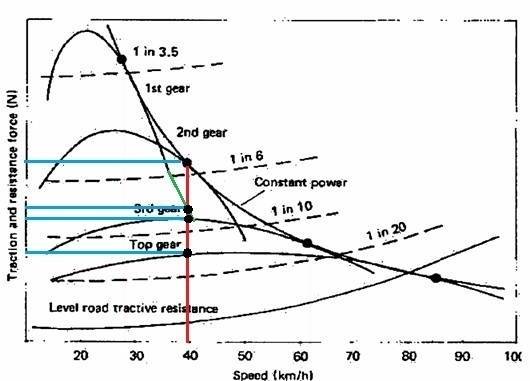

The equation you posted says force = (force X velocity) / velocity. But does maximum force (torque in this case) occur at maximum power? Look at some torque vs. power curves for internal combustion engines. Peak torque occurs somewhat before peak power, not at the same RPM. Remember that power increases linearly with speed. At constant torque, or if torque falls off in a less than 1:1 ratio with RPM the power will continue to rise. If torque falls linearly with RPM the value for power remains the same.

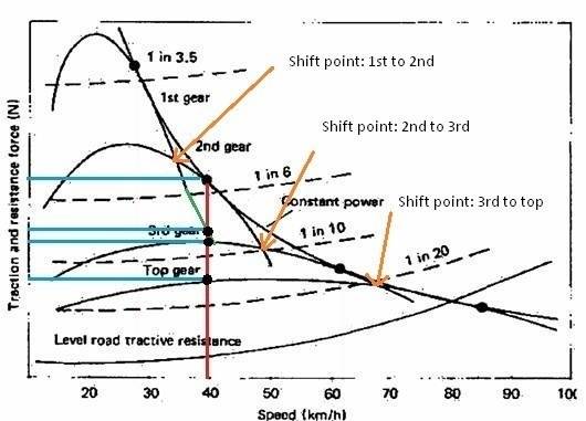

And all those shift point curves could be generated directly from torque curves and overall reduction ratios.
I should add that the last part of your post assumes constant power. Assuming you had a power source that supplied a constant power, then the force falls off linearly with velocity so acceleration decreases throughout the 1/4 mile.
In reply to the two earlier posts, since power is force X velocity any calculation that involves power can be done using force X velocity. The reverse is not true. There are many cases where you cannot substitute power for force X velocity. The example problem of calculating acceleration of a mass knowing the mass and the power is a good example. To solve that you have to know the velocity, converting power to force.
For a given car speed, yes, maximum tractive force always happens at maximum power, that is what [itex]F_{max} = \frac{P_{max}}{v}[/itex] means.

jack action said:
For a given car speed, yes, maximum tractive force always happens at maximum power, that is what Fmax=PmaxvF_{max} = \frac{P_{max}}{v} means.
and
jack action said:
Of course, I assume I'm at maximum power, all the time (like with a CVT for example).
In the first quote, that is not true. As I showed, torque (and so force) can decline while power increases. So maximum force may not (and most probably doesn't) coincide with Pmax.
In the second quote, that also is not generally true. Similarly, it depends on the shape of the torque curve. For example, suppose you have an engine that generates 250 units torque at 7,000 RPM and 233.3 units of torque at 7,500 RPM. The power in both cases is the same (1.75X10^6 units of power). Suppose maximum power occurs at 7,250 RPM. Then it's easy to generate a power curve that would be maximum at that point and yields 242.8 units of torque (1.76X10^6 units of power).
The purpose of any transmission is to change input torque and speed vs.output torque and speed. In cars their purpose is to multiply torque. Drive wheel power is always net engine power less drive train frictional losses. Drive wheel torque is not, it is (net engine torque less drive train losses) X reduction ratio (and modified by rear wheel diameter). And restating, acceleration is related to force, not power. That's also why, for maximum acceleration, it may be better to delay shifting into the next higher gear until past the peak power point. The next higher gear reduces torque across the RPM range.
You can try it yourself. Take a set of engine torque curves from an actual vehicle, use the transmission ratios and lay out rear axle torque curves vs. RPM.
Yes, torque declines when power increases. That is because the rpm increased, and with it the speed of the car too. At a higher speed, the maximum tractive force will always be smaller for a given power (P = F X v). So that is why I said:
But the car doesn't go at the same speed at 7000, 7250 or 7500 rpm.
Let's say I want the wheel to turn at 1000 rpm. The gear ratio needed for having the engine at 7000 rpm will be 7:1. For 7250 rpm, you will need a 7.25:1 gear ratio and a 7.5:1 for 7500 rpm. What are the wheel torque then, knowing the wheel rpm is the same in all cases?
250 * 7 = 1750 units torque
242.8 * 7.25 = 1760 unit torque
233.3 * 7.5 = 1750 units torque
Note how the wheel torque is the same when at 7000 or 7500 rpm; That is because the power is the same in both cases. Yet, the wheel torque is greater at 7250 rpm; That is because the power is greater. And the wheel torque increase is directly proportional to the power increase (1.76X10^6 / 1.75X10^6 = 1760 / 1750).
I did, I put a graph in my previous post especially for that. Here's that same graph with added info:
All black dots on the «Constant power» curve correspond to the maximum power in each gear.
At a speed of 40 km/h, where is the maximum tractive force? In 2nd gear. Why? Because I'm at maximum engine power. In 1st gear (I extended the 1st gear torque curve in green), I'm passed the maximum power rpm, so I produce less wheel torque (even though I'm in a lower gear ratio) because there is less power available. In 3rd gear, I'm at maximum engine torque, but because I have a higher gear ratio, I produce less wheel torque than in 2nd gear. How could I've known that in a simpler manner? Well, I also knew that I produce less power at maximum engine torque, and the wheel torque decrease is proportional to the engine power decrease. If the power would have been the same, it would have produce the same traction force as in 2nd gear. In top gear, there's even less power because of the higher gear ratio that set my engine rpm even lower.
See, at any car speed, the maximum tractive force is always at maximum power.
That is why you can draw the curve [itex]F_{max} = \frac{P_{max}}{v}[/itex] and you will know for sure that you will never be able to set the tractive force outside the green envelop (see below); The upper (white) region is off limit, no matter the gear ratio, tire diameter or if you produce that power with an electric motor, a diesel engine or a gas turbine.
