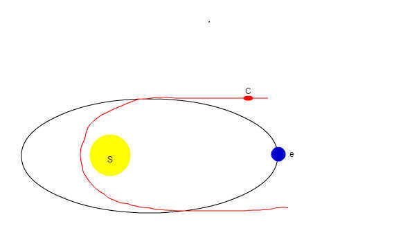

Can you clarify the phrase: "find the time required for the comet to transit into the Earth orbit around the sun "? Transit from where? You need to specify the portion of the orbit involved.
Do you mean the time spent by the comet closer to the Sun than the Earth (within the orbit of the Earth)?

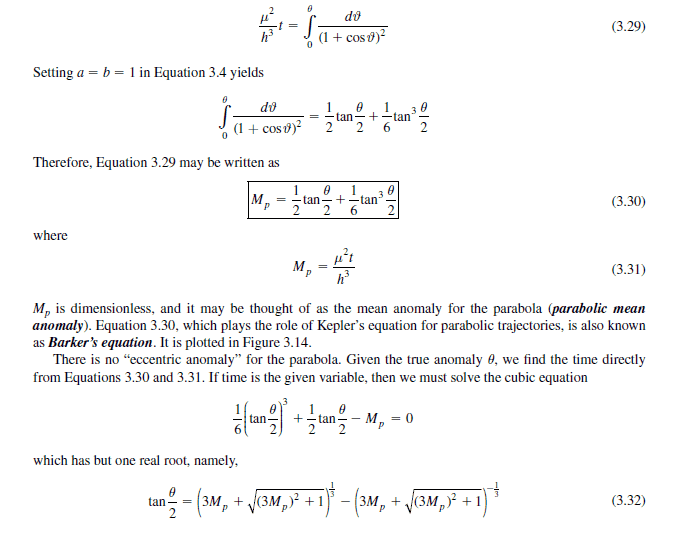

By the way, the quoted material is not correct when it states that the is no "eccentric anomaly" for the parabola. There is what is called the Parabolic Eccentric Anomaly, often denoted by D where
##D = \sqrt{p}~tan~\frac{\nu}{2}##
See, for example, "Fundamentals of Astrodynamics" by Bate, Mueller, and White, chapter 4.

the problem is i don't quite understand the problem , and I've translated the problem form Persian to English . another translation that could be told is :
A comet is orbiting around the Sun in a parabolic orbit . Assuming the distance between the center of the sun to perigee of the comet's orbit is 58 million km, find the duration the comet spends in Earth's orbit.

Change "in" to "within" then I would agree with this interpretation. That is, find the time that the comet spends closer to the Sun that the Earth.
I think the best question before any attempt for solving the problem is : "Can a comet, while staying in it's own orbit, spent some time on Earth's orbit around the sun?"
Earth's orbit is an ellipse while the comet's is parabolic. They are different geometrical shapes that won't coincide for any length of time. The best that can happen is an intersect (crossing), which would happen in an instant of time.

Again, it depends on your definition of "in". Clearly the image shows the comet's orbit spends a portion of its time within the Earth's orbit.
Note that the eccentricity of the Earth's orbit is very small so it's very close to circular. It's highly likely that you can treat it as circular for the purposes of this problem, otherwise they would have given you precise orbit details and timings to work with for both bodies.
