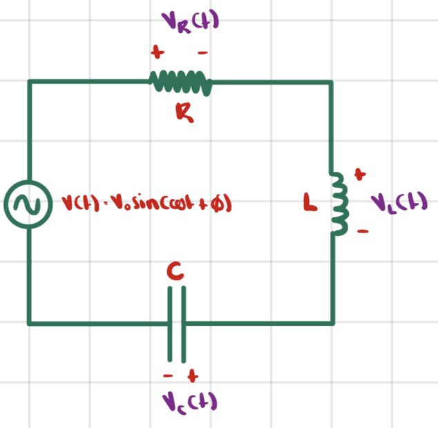

We start with the driven RLC circuit below
The AC source voltage is ##V(t)=V_0\sin{(\omega t +\phi)}## and we would like to find the current ##I(t)=I_0\sin{(\omega t)}##.
Using Faraday's law we have
$$V(t)-V_R(t)-V_C(t)=L\dot{I}=V_L(t)\tag{1}$$
$$V_0\sin{(\omega t+\phi)}-IR-\frac{Q}{C}=L\dot{I}\tag{2}$$

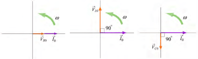

First they consider the instantaneous voltages across the resistor, the inductor, and the capacitor.
Here are the phasor diagrams for the relationships between current and voltage in these three circuit elements.
For the record, phasor diagrams are new to me.

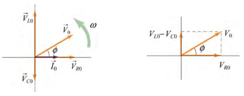

Using the phasor representation, Eq. (1) can be written as
$$\vec{V}_0=\vec{V}_{R0}+\vec{V}_{L0}+\vec{V}_{C0}\tag{4}$$
as shown in the next figure
Again we see that current phasor ##\vec{I}_0## leads the capacitive voltage phasor ##\vec{V}_{C0}## by ##\pi/2## but lags the inductive voltage phasor ##\vec{V}_{L0}## by ##\pi/2##.
The three voltage phasors rotate counterclockwise as time increases, with their relative positions fixed.
I understand this last paragraph on some level because before analyzing the current circuit, I analyzed three different circuits: an AC source with just a resistor, with just an inductor, and with just a capacitor.
I think I just need to be explicitly told why the phasors are the same in those three previous circuits as they are in the current circuit. Is it superposition because each circuit element is linear?
It is also not clear why we can justify going from (1) to (4).
After this, it is simple to obtain an expression for the amplitude of the current.
We simply look at the rhs plot above and compute ##V_0## using Pythagorean theorem.

So again, from the rhs plot above, we get
$$V_0=I_0\sqrt{X_R^2+(X_L-X_C)^2}\tag{10}$$
and so the amplitude of the current is
$$I_0=\frac{V_0}{\sqrt{X_R^2+(X_L-X_C)^2}}\tag{11}$$
From the same rhs plot above we can determine that the phase constant satisfies
$$\tan{(\phi)}=\frac{1}{R}\left ( \omega L-\frac{1}{\omega L}\right )\tag{12}$$
Therefore the phase constant is
$$\phi=\tan^{-1} \frac{1}{R}\left ( \omega L-\frac{1}{\omega L}\right )\tag{13}$$

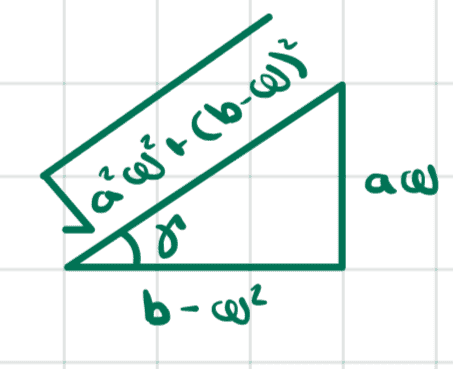

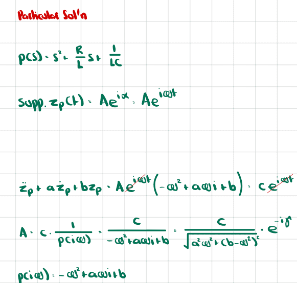

Here is how I solved the differential equation (3).
Complexifying (3) we have
$$\ddot{z}_p+a\dot{z_p}+bz_p=ce^{i(\omega t+\phi)}\tag{14}$$
where ##a=\frac{R}{L}##, ##b=\frac{1}{LC}##, and ##c=\frac{V_0\omega}{L}##.
We try a solution ##z_p(t)=Ae^{i(\omega t+\phi)}## and find
$$A=\frac{c}{p(i\omega)}\tag{15}$$
where ##p(s)=s^2+as+b## is the characteristic polynomial for the differential equation.
##p(i\omega)## introduces another phase constant. This is probably not what we want, but I am not sure what to do about it.
$$p(i\omega)=-\omega^2+a\omega i+b\tag{16}$$
Therefore
$$A=\frac{c}{-\omega^2+a\omega i+b}=\frac{1}{\sqrt{a^2\omega^2+(b-\omega^2)^2}}ce^{-i\gamma}\tag{17}$$
Our complex solution is then
$$z_p(t)=Ae^{i(\omega t+\phi)}=\frac{1}{\sqrt{a^2\omega^2+(b-\omega^2)^2}}ce^{i(\omega t+\phi-\gamma)}\tag{18}$$
The real solution is
$$I_p(t)=\frac{1}{\sqrt{a^2\omega^2+(b-\omega^2)^2}} c\cos{(\omega t+\phi-\gamma)}\tag{19}$$
$$=\frac{V_0}{\sqrt{R^2+\left (\omega L-\frac{1}{\omega C}\right )^2}} \cos{(\omega t+\phi-\gamma)}\tag{20}$$
$$=\frac{V_0}{\sqrt{X_R^2+\left (X_L-X_C\right )^2}} \cos{(\omega t+\phi-\gamma)}\tag{20}$$
Note that
$$\gamma=\tan^{-1}\left (\frac{a\omega}{b-\omega^2}\right )\tag{22}$$
$$=\tan^{-1}\left ( \frac{R\omega C}{1-\omega^2LC}\right )\tag{23}$$
In the calculations in post #2, the phase constant is actually ##\phi-\gamma##.
The expression for ##\tan^{-1}{(\gamma)}## is similar to the one found for ##\tan^{-1}{(\phi)}## in the notes (shown in post #1), but the argument of the ##\tan^{-1}## is inverted.
The phase difference between the voltage and the current is, however, just ##-\gamma##, so taking this into account my calculations seem to make sense (except for the detail of the argument of ##\tan^{-1}## being inverted)
The issue of my expression ##\gamma=\tan^{-1}{\left ( \frac{R\omega C}{1-\omega^2LC}\right )}## is also a problem because of the following.
What you can do about it is not try a solution ##z_p(t)=Ae^{i(\omega t+\phi)}##. The constant phase ##e^{i\phi}## is part of A at this point. So try ##z_p(t)=Ae^{i \omega t}## and see what happens.
kuruman said:
What you can do about is not try a solution zp(t)=Aei(ωt+ϕ). The constant phase eiϕ is part of A at this point. So try zp(t)=Aeiωt and see what happens.
Already did that. As I expected, it doesn't make any significant difference to the results.
The only thing that changes is that we remove the ##\phi## from the cosine in the expression for the current.
##\phi## is after all just an arbitrary offset for the AC voltage.

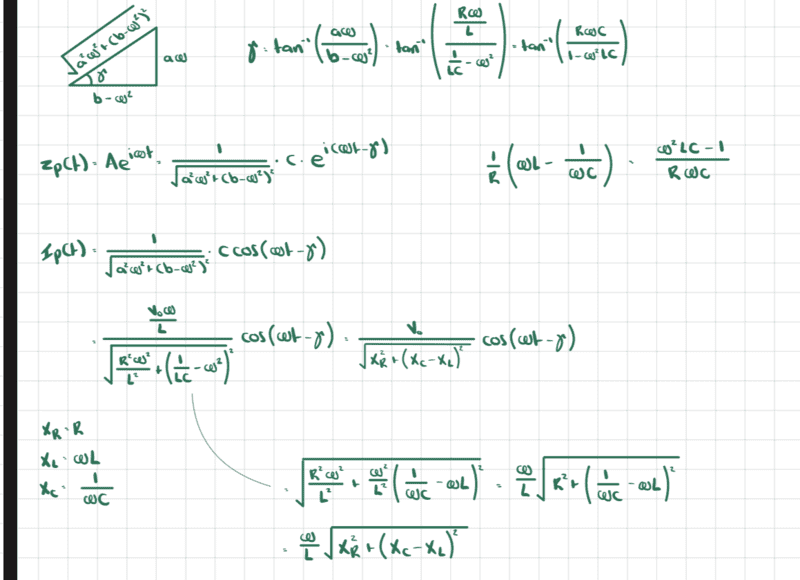

For the record, here are my calculations

Note that your ##\gamma## and their ##\phi## are related by ##\gamma+\phi=\frac{\pi}{2}.## The tangent of your angle is equal to the cotangent of theirs. Just swap the right sides of your triangle to bring it into agreement with theirs. Your ##b-\omega^2## horizontal side corresponds to their ##V_{L0}-V_{C)}## vertical side. Conventionally, the phase angle is measured relatively to the voltage across the resistor which is in phase with the current.
Likes zenterix
Ok, so as @kuruman noted we need need to deal correctly with the angles.
Here is what is happening in more detail.
Recall that the AC source voltage is
$$V(t)=V_0\sin{(\omega t+\phi)}$$
and the steady-state current we computed was
$$I(t)=I_0\cos{(\omega t+\phi-\gamma)}$$
Let's write the voltage in terms of cosine.
$$V(t)=V_0\cos{\left (\omega t+\frac{\pi}{2}+\phi\right )}$$
We can see that in fact the phase difference between the voltage and the current is ##\beta=\frac{\pi}{2}+\gamma##.
This is the phase constant we are interested in.
$$\tan{(\beta)}=\tan{\left (\frac{\pi}{2}+\gamma\right )}=(...)=-\cot{(\gamma)}=-\frac{1}{\tan{(\gamma)}}$$
We already know what ##\tan{(\gamma)}## is: it was computed when we solved the initial inhomogeneous differential equation.
Therefore,
$$\tan{(\beta)}=-\frac{1}{\frac{R\omega C}{1-\omega^2LC}}$$
$$=\frac{\omega^2LC-1}{R\omega C}$$
This last expression matches what was in the notes.
Also, it makes sense now since this is the tangent of the phase difference between the voltage and the current.
What I was initially computing was the phase difference between the current and the input to the differential equation
$$\ddot{I}+\frac{R}{L}\dot{I}+\frac{1}{LC}I=\frac{V_0\omega}{L}\cos{(\omega t+\phi)}$$
But this input isn't the same as the AC voltage.
