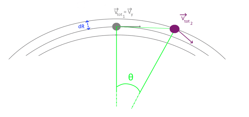

I would like to calculate the orbital velocity using the geometrical way of reasoning. But I have a hard time to understand and apply some basics into my calculations.
The reasoning is pretty simple. After some time: dt ,the particle travels the distance: Vtot1 * dt = R*sinθ (see the attached image). In order to stay on orbit the velocity of the particle must change accordingly, by conserving the absolute value of the velocity and changing the velocity vector by θ.
Here is the problem that bothers me. Since the initial velocity Vtot1 = Vy is perpendicular to the center of the gravitational field, after time dt the orbital radius will increase from R to R+dR (see the attached image). In this case, it means that in order to stay on the orbit; the velocity Vtot2 must be different from Vtot1. Thus, it seems to me that this problem becomes more complicated.
- Does this reasoning make any sense?
- Are there any mistakes?
- Could you please guide me into solving this calculation. it's really important for me.
Sorry for my English.

It looks like you are assuming strictly circular orbits. Is that correct? If so then the orbital velocity is just the magnitude of the initial velocity times a unit vector tangent to the circle at each point. That is fully geometrical.
What you have here is not actually a geometrical approach, but rather a numerical method called Euler's method which is known to fail for this sort of computation for the reason that you have found. If you want a better numerical result then you will need to use a better method. You may look into Hamiltonian methods, but even a standard Runge Kutta approach will be better than Euler's method.
This statement is self-contradictory. For the radius to increase, you need a radial component of the velocity. If the velocity is perpendicular to the radius, there is no such component. Think of a mass swirled in a circle at the end of a string.

Hi Dale,
Thank you for your response. You are right I'm interested in circular orbits only.
Ok, at least I know that what I'm trying to do is a numerical method and not geometrical. I'm really surprised that there is no easy solution for it. I'll try to look into the Runge Kutta approach and see what I can get.
Can it be that the assumption V1 = Vy is perpendicular to the radius at t=0 is false? Maybe at t=0 the angle between the velocity vector and the radius is already < 90 degrees?
What I'm trying to say:
if at t=0 the velocity vector is perpendicular to the radius the particle will travel in strait line (in y direction) during dt, this implies that the position of the particle shifts to R + dR.
In order to stay on the orbit R, the initial velocity vector can not be perpendicular to the radius. At least this is what I'm thinking, maybe I'm wrong. This is why I need help with this question.

That's a common mistake. A velocity vector is mathematically defined at a single point. ##dt## is the limit of ##\Delta t##, as ##\Delta t \rightarrow 0##.
If you use a small ##\Delta t##, then you model the orbit as a polygon with many sides.
Otherwise, you model the orbit using calculus, which gives a circle.
No, that assumption is correct. The issue is that the velocity is the derivative of position, and your drawing represents a discrete time approximation to the derivative, not the derivative itself. It is this approximation which is bad and the Runge Kutta method or the Hamiltonian methods will give a better discrete approximation.

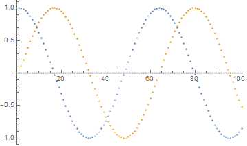

Just for demonstration I implemented the two above methods. I used ##G=M=1## with ##r_0=(1,0)## and ##v_0=(0,1)##. I used ##\Delta t = 0.1## and simulated from ##t=0## to ##t=10##. That ##\Delta t## is rather coarse, but shows the point well. I plotted the ##x## and ##y## components of ##r(t)##
The ideal curves are

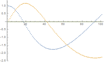

When I use Euler's method the approximate numerical curve is
You can easily see that this deviates strongly from the ideal curve, and gets pretty bad pretty quickly. This is why Euler's method is generally a poor method to use for all but the most trivial tasks. The problem that Euler's method has is exactly the one that you posted about. As time goes on, it drifts further and further away from the orbit that it should be on.

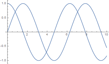

With the Verlet method the approximate numerical curve is
This is clearly a much better approximation to the ideal curve.
