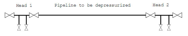

Since it is not a issue right now and I'm preparing for when it might arise I have no detailed diagram to send.
It should look like example (very crude) below:
Pipeline has a diameter of D, heads can have a diameter equal or greater than D. Heads are considerably shorter than pipeline, for example Head length is 5 meters (m), pipeline length 50000 m. Heads are pressurized to the same pressure as the pipeline.
Let's say the pipeline will be depressurized from head 1 and on one of those side pipes orifice plate will be installed, by opening the valve fully pressure will be released through the orifice plate to ambient pressure of 30 bar (300 m depth).
Since we are talking only about estimate, we can disregard pressure losses across head equipment.

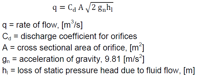

I started with the following expressions:
Pipe expansion is taken into consideration with above expression.

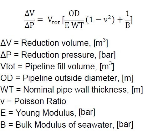

Volumetric expansion of liquid due to reduction in pressure is calculated with the following expression: V1 = V0 (1 - (p1 - p0) / E), but I have trouble incorporating it with expressions stated above, I assumed ΔV was needed reduction volume.
Problem is that the pressure reduction rate inside of the pipeline should not exceed 0,5 bar per minute, and since the valve for pressure release will be open fully from the start, orifice plate should restrict flow enough to ensure the maximum allowed rate of depressurization is not exceeded.
Since I'm trying to make a template (pipelines will range from 50m to over 50000 meters) for this calculation and it is an estimate, can we disregard the speed of sound time delay? Does it have a big influence on the overall results?

I see what your problem is. From your second equation, we get the density of the liquid in the pipe as:
$$\rho=\rho_0+\rho_0\left[\frac{D}{EW}(1-\nu^2)+\frac{1}{B}\right](P-P_0)$$where ##\rho_0## is the density at ##P_0=30## bars. Your first equation can be expressed as $$q=AC_D\sqrt{\frac{2(P-P_0)}{\rho}}$$ (although usually, the ##C_D## is inside the square root sign). The mass flow rate through the orifice is $$\dot{m}=q\rho=AC_D\sqrt{2\rho(P-P_0)}$$The total mass of water in the pipe at any time is $$M=\rho \frac{\pi D_i^2}{4}L$$So, the rate of change of mass in the pipe is
$$\frac{dM}{dt}=-\dot{m}$$So,$$ \frac{\pi D_i^2}{4}L\rho_0\left[\frac{D}{EW}(1-\nu^2)+\frac{1}{B}\right]\frac{d(P-P_0)}{dt}=-AC_D\sqrt{2\rho_0(P-P_0)}$$This assumes that all the fluid in the pipe is at the same pressure, which is an OK assumption for a fairly short pipe. However, for a long pipe (e.g., 50 km), that will not be the case.

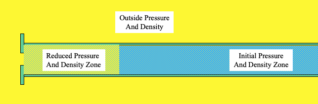

I've done an analysis of the infinitely long pipe case, assuming release of compression in an inviscid fluid. See the figure below.
The analysis shows three regions:
The first region is outside the pipe, where the density and pressure are that of the surrounding sea water, at ##\rho_0## and ##P_0##.
The second region is within the pipe, far from the orifice plate, where the pressure and density of the fluid have not yet changed from the original pressure and density of ##P_i## and ##\rho_i##.
The third region is within the pipe, starting at the orifice plate. This region is one of uniform lower (reduced) density and pressure than the initial pressure and density, but higher pressure and density ##P_r## and ##\rho_r## than outside the pipe. . The pressure and density in this region do not change with time, but the region grows larger with time. The interface between the third and second regions propagates to right at the speed of sound in the system c, where $$C=\sqrt{\frac{B^*}{\rho}}$$with $$\frac{1}{B^*}=\left[\frac{D}{EW}(1-\nu^2)+\frac{1}{B}\right]$$
All the increase in volume resulting from releasing the pressure in zone 3 exits through the hole in the orifice plate. The analysis shows that the volume rate of flow out of the orifice plate is given by the equation $$q=\frac{(P_i-P_r)}{B^*}A_PC=\frac{(P_i-P_r)}{\sqrt{\rho B^*}}A_P$$where ##A_P## is the cross sectional area of the pipe. This volume flow rate must match that calculated from the discharge equation for the orifice plate, which is driven by the pressure difference between region 3 and the region 1 outside the pipe:
$$q=AC_D\sqrt{\frac{2(P_r-P_0)}{\rho}}$$where A is the area of the orifice plate. Therefore, $$\frac{(P_i-P_r)}{\sqrt{B^*}}A_P=AC_D\sqrt{2(P_r-P_0)}$$ This equation can be solved for ##P_r## to determine the pressure in region 3.
Basically, what this idealized analysis shows is that, after the orifice is opened, the pressure in the pipe region immediately adjacent to the orifice plate immediately drops to a new lower value, and then stays at that value for all time (or, basically, until the expansion wave reaches the far end of the pipe, hundreds of km away).
