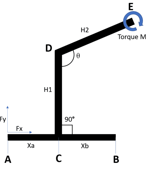

Hello, I would like to request some help in solving this mechanics problem.
Consider the attached drawing of a solid structure which is pinned to the ground on points A and B.
Distances AC=Xa, CB=Xb, CD=H1 and DE=H2
A torque with magnitude M is applied on point E. How do I determine the resulting forces from this torque Fx and Fy on point A and point B ?
This would be the equation for torque M
M=r*F
My guess is that we can bypass the "middle" geometry of the structure, and simply use the distance from point A to point E (let's call it RAE), and its angle with the horizontal (θAE).
The resulting force would thus be F = M/RAE, with Fx = Fcos(θAE) and Fy = Fsin(θAE). A similar approach would be applied for point B.
Is this correct ?
Thanks in advance !

Hello Jony, ##\qquad## :welcome: ##\qquad## !
When I try to look at the picture I get something almost black on black. Can you fix that ?
The principle is simple: make force and torque balances. If you pick your axis conveniently, the work you need to do can be minimum.
You can't, at least not in that general sense.
Suppose you have a solution. You could add a force to the right at A and an equal and opposite force at B and it would still be a solution.
Other than that, follow @BvU's advice.

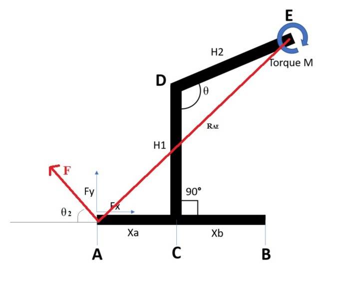

Fx and Fy that I want are simply the forces from applied momentum M. If we approach it as a traditional "static" problem then I guess we can simply imagine that A and B are "screwed" to the ground, and whatever forces result from the momentum are the normal reaction forces on this screw, i.e., the screw reacts on the structure with opposite forces to the resulting ones from the torque.
I have drawn what I meant initially in this updated picture. From here we get that Fx = -Fcos(theta2) and Fy = Fsin(theta2), with F = M / RAE
As I posted, you need to specify your axis. From your diagram, you appear to be taking point E as your axis, but your equation must then include all forces that have moment about that axis. This will include the forces at B.

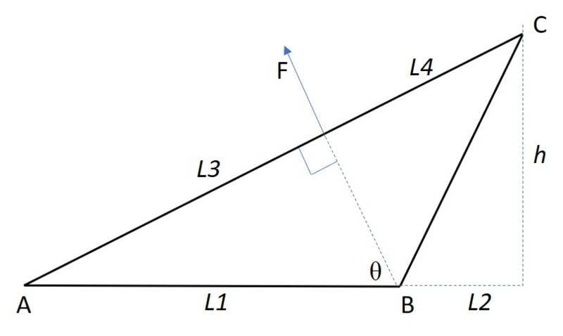

of course i see what you mean now, yes the axis of rotation is on point E, but of course the forces from the moment applied there will distributed on points A and B, so it's the sum of the momentum from both those forces will equal M. Can't do the math now but I'll come back here tomorrow :)
I drew a new picture to explain the new approach.
We have points A, B and C of a rigid structure. The force "F" is such that it's momentum on point C is M, so that M = F * L4.
In order for the structure to be static, the reaction forces on points A, B and C will have to obey the system of equations:
F=M/L4
ΣFy = 0 -> FAy + FBy + Fsin(θ) + FCy = 0
ΣTorque(A) = 0 -> F*L3 + FBy*L1 + FCy(L1+L2) = 0
ΣTorque(B) = 0 -> FAy*L1-FCy*L2 = 0
Is this the right approach ? anything wrong/missing on my equation system ?

Jony S said:
The force "F" i
But what is this force F? And what is FCy?
There are only the forces at A and B and the moment M.
If you won't follow my hints in post #9, start by considering the X components of the forces at A and B. Write down that force balance.
For clarity here, you are making several incorrect assumptions. Firstly, Forget about the Fx reaction forces at A and B. They are essentially zero in this case, whether both supports are pinned or one is pinned and the other is roller or simply supported. And even if there were Fx forces, they would not be related to the Fy forces in the manner you have shown.
Secondly, Point E is on the axis of the applied moment M (which you incorrectly call momentum, leave off the -um). But you can choose ANY point to be the axis about which to sum moments, as has been hinted at in prior posts.
Thirdly, did you know that the moment of an applied moment about ANY point is the applied moment itself??
Focus on solving your Fy forces at A and B by conveniently choosing the point about which to sum moments (as has been noted by Haruspex).

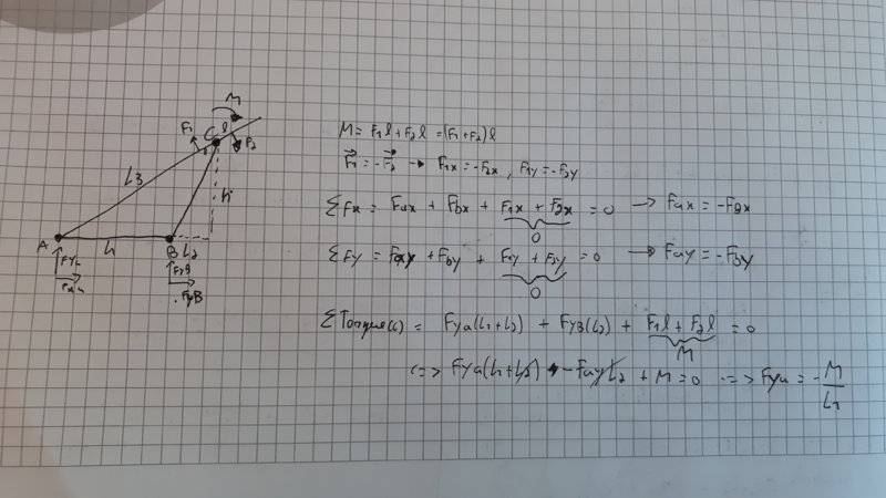

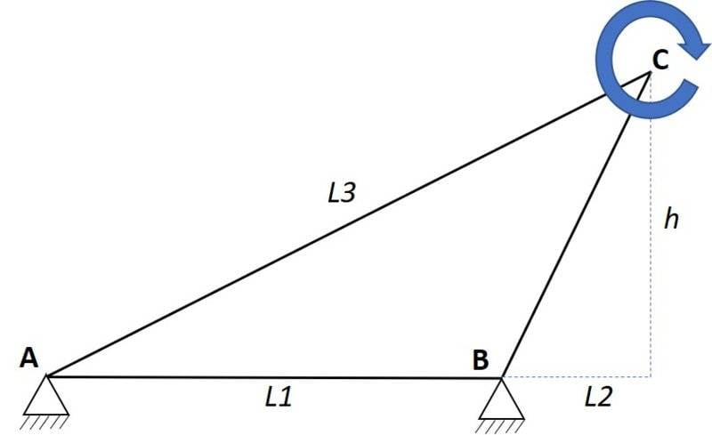

Hey guys, sorry about the delay,
yes forget about Fcy, that's silly, and yes Fxs will cancel, I got that :P
Now, if I exclude my force "F" (the one that makes moment M) and just assume there's an applied moment M on point C /(with no "translational" force), I will ultimately get something which doesn't sound physical to me.
ΣFy = FAy + FBy = 0
ΣFx = FAx + FBx = 0
ΣTorque_C = M + FAy(L1+L2) + FBy*L1 - FAx*h - FBx*h = 0
Since FAx*h + FBx*h = (FAx+FBx)*h = 0, the last equation is simplified.
From here i get that FAy = -Fby = -M/L1
Now, this means that if L1 tends to zero, i.e., the two pinned points are very close together, FAy tends to infinity, which isn't intuitive at all, so I still think there's something missing here...
If I add forces F1 and F2 that produce moment M, but are symmetric so that it doesn't introduce translation to the system, I get the same solution (in the picture, sorry for bad handwriting :) )
Jony S said:
FAy = -Fby = -M/L1
Correct, depending on your sign convention for the forces and moments.
The easier route is to take moments A (and likewise B). This has the merit that M and FBy are the only terms.
True. Try turning a long bar only holding it in the middle when someone else is turning it the other way while holding it near the ends.
True, the end solution is the same, but I wasn't sure if the moments at A/B were simply M+FB/Ay*L1, because it's wasn't clear to me if moment M is somehow distributed between A and B or if it actually is M in both points (plus the Fy*L1 of the other point)
Thanks for the help :)
