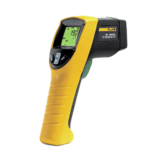

What is the cube made of, how big is it and how are you measuring its surface temperature? Do you have access to an infrared thermometer? That would take about 1 sec after the microwave shuts off.
You can measure the rate of temperature change by measuring the temperature twice and linearly extrapolating backwards. Maybe you'll find the rate is low so this doesn't matter. When the microwave is on you're probably zapping it with 100x more power than rate of loss after it is shut off.
Likes berkeman
That was my first thought as well. I use one in the lab pretty often for all kinds of thermal measurements...
https://www.digikey.com/en/products...xnZe5NryTfS5sARzWHqTPeXYGgFIV8TEaAgPDEALw_wcB
Likes russ_watters
