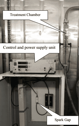

Let me to explain it better.
I have these devices as you can see in the picture attached.
The capacitor become charged up to 18.5 kV and releases the energy to the discharge switch and then the energy in form of pulses go through the electrodes in the chamber.
I am asked to calculate the energy which goes from the electrodes to the liquid in the chamber.
I guess for that I need to draw the exponential decay curve and calculate the area underneath.
I don't know how and where to start.
Please help me from the scratch (I have forgotten all the basic physics from high school)
P.S. This is not a homework. I am a master student working on my final project :sorry::cry:

It isn't clear what is actually happening in this circuit.
What forms the pulses? Are you referring to some sort of high voltage oscillation due to the spark gap and some resonance in the circuit or does each pulse get generated by the 'Grey box' in the picture? What initiates the discharge? Is it when the spark gap breaks down?
Can we have a proper circuit schematic of the setup?
Likes Sara87
The owner of the device told me they are exponential decay pulses. yes it gives high voltage pulsed electrical field (20 kV/cm) within the liquid material in a treatment chamber in a very short period of time (4 µs).
Yes the discharge will happen at the breakdown voltage of the spark gap.
Unfortunately I don't have any better picture.

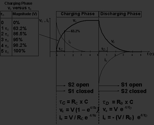

I was told to calculate the
and then I will be able to calculate the area under the curve in the picture attached.
You have the functions V(t), I(t) and τ=RC=1 μs-1.
But, energy is not the area under the curves. The axis is V(t), not V(I).
We calculate energy by:
$$ E = \frac{1}{2}CV_0^2 $$
To calculate C we must know the value of R.
If we have no this information we can see that the charge currency is the same to uncharge. So energy must be:$$ E=\int_0^{5\tau}V(t)I(t)\,dt = V_0I_0\int_0^{5\tau}(1-e^{-t/\tau})e^{-t/\tau}\,dt \approx \frac{1}{2}CV_0^2 $$ If we can assume that:
$$ V_0I_0 \approx 200 (w) $$ approx the source power then we have:$$ E \approx \frac{1}{2}V_0I_0\tau \approx 100\tau = 10^{-4} (J)$$per cycle.
Integral calculated from 0 to infinity and is τ/2.
Likes Sara87
Cycle time is 10τ so the power is:
$$ P = \frac{10^{-4}}{10^{-5}} = 10 (watts) = 5\% \text{ of power supply or less} $$
