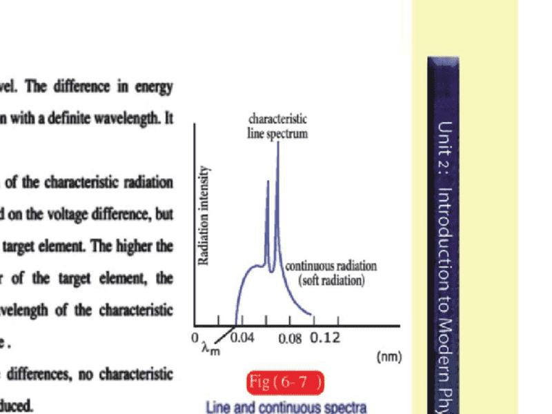

In my excercise book, I was given a typical diagram as that in Fig (6-7) above.
And the problem statement says:
The diagram presents the x-ray spectrum produced by Coolidge tube. Determine the least potential difference needed to produce the characteristic radiation.
E= hƒ = hc/λ where: h is Planck's constant, ƒ is the frequency, c is light speed and λ is the wavelength)
K.E= eV
[/B]
I really don't know how to start in this, because the diagram doesn't appear to be precise, I mean I don't know actually the precise shortest wavelength where the characteristic radiation appears in the diagram, would it be 0.07nm?!
If it would be 0.07nm, I will do this:
E=hc/λ=(6.625*10^-34)* (3*10^8)/ (0.07*10^-9)
=2.8*10^-15 j
Then,
eV= E -----> V=E/e = (2.8*10^-15)/ (1.6*10^-19)
=17.5 kV.
But I don't think my approach is correct, so I am waiting your help.

Can you come up with abetter estimate? λm is to the left of the 0.04 nm mark.
OK, but it is λm of the bremsstrahlung radiation not the characteristic, isn't it?
I say that my approach is wrong because I don't actually understand the problem or how to start.
Y
Correct. Now suppose you have an electron accelerated to energy E. Consider two cases after it slams into the target: (1) it produces a single photon of energy E; (2) it produces two photons each with energy E/2. In which case is the wavelength shorter?

Note that we are trying to get the potential difference (1) through which the electron is accelerated.
Note that (1) is related to the energy of the electron (2).
Note that, if (2) goes into producing a single photon, this photon has the minimum wavelength λm (3).
Note that you can read (3) off the plot.

The accelerated electron through the PD, can produce either a bremsstrahlung spectrum or a characteristic spectrum, right? The bremsstrahlung has its own minimum wavelength, the characteristic spectrum has its own minimum wavelength too, right?
The minimum wavelength of the bremsstrahlung can be estimated to be 0.035nm whilst the minimum wavelength of the characteristic is (in my opinion) directly below the left peak of the characteristic line spectrum, e.g., 0.07nm.
Are those points correct?

I don't know which wavelength (0.035nm or 0.07nm) is to be used to solve the problem.
Use the minimum wavelength. Minimum means smallest. Which is smaller, 0.035 nm or 0.07 nm?
