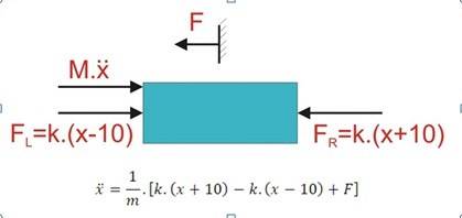

I want to simulate such a system in Simulink.
It is a system of mass between two compression, spring preload. Springs are compressed length of 64 mm to 54 mm. Acts on mass shock 50G for 10ms. The coefficient of spring constant is changed depending on the position and direction of movement mass.
But I can not deal with the equation.
So far I only have such an equation, but probably not correct.
how to calculate such a system?
You have the wrong differential equation. Simulink will be of no use until you get the correct DE.
Draw a FBD for the mass and apply Newtons 2nd law.
Hi, I have a thought that I have a bad differential equation. I do not know how to start, how do I calculate such a system, see. my picture.
Because if there were extension springs, it would be easy.
However, if used compression springs, so that's then I do not calculate.
First, a question: Are these springs attached to the block (so that they can apply tension as well as compression), or are they compression only?
If they apply compression only, then when the displacement of the block exceeds the initial compression, one of the springs will exert zero force. If they are attached to the block, then they can apply tension forces when the displacement would otherwise disengage them.
Start from the beginning by writing the force in each springs as a function of the position of the block. Then write Newton's 2nd law (Sum F = m*a) to get the differential equation.

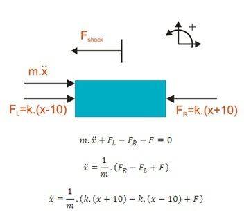

I don't think you have ever said so, but I presume that the two springs are identical, and you did indicate that they operate in compression only. Your top figure shows each spring with a free length of 64 (mm?) and a equilibrium compressed length of 54 mm. Thus the initial compressive force in each spring is k*(10) = 10 k. Consider x to be measured to the right from the equilibrium position of the block. The spring forces are
For left spring ---
FL = k (x-10) for x <= 10
and
FL = 0 for x > 10
For right spring ---
FR = k (x+10) for x >= -10
and
FR = 0 for x < -10
Then the equation of motion is
m*(d2x/d2t) = FL - FR
where FL and FR are given by the piecewise descriptions above.
Notice that for abs(x)<=10, the stiffness is 2*k, for for abs(x)>10 the stiffness drops to simply k.

Notice also that there is no M.d2x/d2t force, so this should not appear in the FBD. Also, I don't recall there being an F in the original problem statement (no subscript), so this needs to be removed from the FBD as well (unless I have overlooked something).
The equation of motion is, as I wrote it above,
So once again. Because I'm not even sure if I understand you.
Mass is between two compression springs. Force is applied on the system about the size of 50G for 10ms.
So the way it is right now?
You seem to be quite confused on what Newton's Second Law says (have you been drinking d'Alembert?). Newton's Second Law says
M.a = sum of forces
What you have written looks like
M.a + sum of forces = 0 (that confusing d'Alembert stuff!, stay away from it!)
Do you see the difference?
Your FBD should not include an arrow labeled m.x-dot-dot. This is not a force! Only show forces on the FBD.
If you think m.x-dot-dot is a force, ask yourself where the reaction forces is. The third law says that for every force (action) there is an equal and opposite force (action) somewhere in the universe. Where is the reaction to the m.x-dot-dot term? There is not any, not to be found anywhere in the cosmos!
Also, you have written the forces in the form that is valid only for abs(x)<=10. This cannot be strictly correct because the forces require the piecewise definition I gave earlier.
I edited fig. for better understanding. So the resulting equation is as follows?
Look at your equation and ask yourself, "How can this apply to the 4th figure down where the right-side spring has lost contact with the block?"
It is true, the fourth image above equations will not apply because we get a negative value. Then what next?
