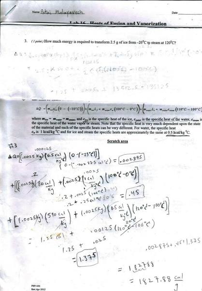

Hi, I am answering Question #3, and using the formula and variables above scratch area as reference on how to answer the question.
Could someone please have a look and see if the problem I worked out came out correct.
First I converted g = kg
I used the given variables, then I work out the problem, I made sure to do the paranthesis first before multiplying the variables in,
then converted back to kg and finally came with the answer
1827.88 cal/g heat transfer, did i use the correct unit? joules?
Any input would happily appreciated
You're answer is in the right ballpark (but a bit low). You've specified your heats of fusion and vaporization with units of cal/kg, whereas the number magnitudes look like they're more suited to being kcal/kg or cal/g. Check them.
The final result should have units pertaining to heat only: either Joules or calories.
ok thanks,
