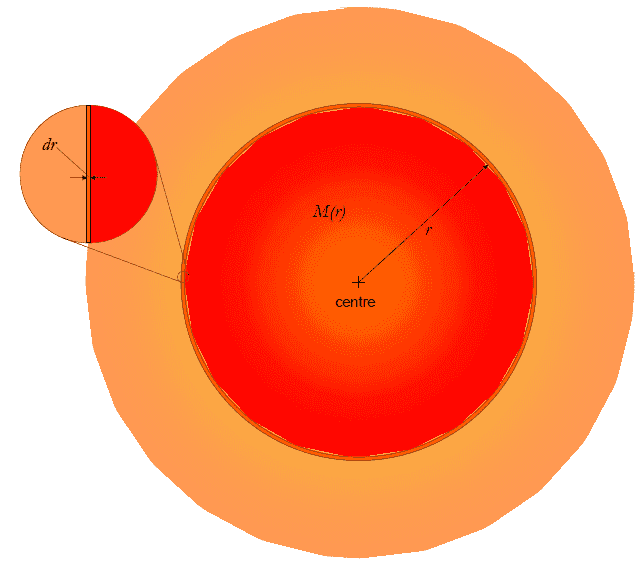

- The mass distribution equation as ordinary differential equation:
$$\frac{dM(r)}{dr} = 4 \pi r^2 \rho(r)$$
and as integration:
$$m(r) = \int^r_0 4 \pi r^2 \rho dr$$
yields the mass m(r) inside a spherical shell of radius r. This equation describes the mass M(r) contained within a radius r in terms of the mass density ρ (rho).]

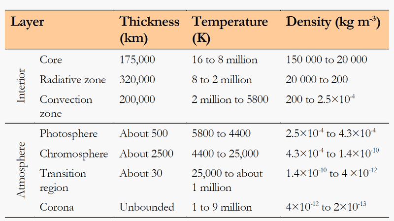

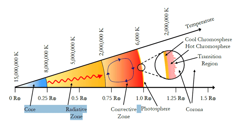

Assuming the Sun’s core has a mass of 0.35 Msolar_mass and taking values for other quantities from a internet background search or from the following figures
(i.e.: Radius "solar core" = 0.25 Rsolar_radius ):
a.
Determine the density at the centre of the Sun.
Compare this with the mean density of the core.
Comment on the result.
[Hint 1: Its not about the density at R=0, which may confuse a bit as mass inside a sphere of radius R=0 is of course 0. But density is defined as mass per unit volume: You can imagine a small volume at the centre of the Sun, having mass.]
[Hint 2: You can use an derivative (i.e. an second order differential equation) of one of the "equations of stellar structure" to solve this question.
I.e.: The mass distribution equation as ordinary differential equation
and as integration:
b.
Determine the density of the white dwarf, Sirius B, whose mass, M = 1 Msolar_mass, and radius, r = 0.008 Rsolar_radius.
Compare it with the density of the Sun’s core.
c.
Determine the density at the surface of the core of the Sun.
Using this density, calculate the rate of change of pressure with radius at that surface.
