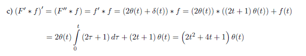

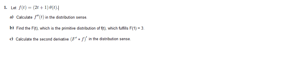

I've some questions in the c) part of the task. The texts in the pictures are loosely translated, so let me know if there is something that is unclear.
Is there a specific reason why they wrote (F' * f)' instead of (f * f)' ?
I've posted a solution at the bottom of the post but I don't understand the first step: (F' * f)' = F'' * f.
Is this some standard trick that always applies?The way I would write is $$f' * f = ( 2\theta(t) + \delta(t) ) * (2t+1)\theta(t)$$, I don't see how it becomes what is written in the solution.
If someone knows of any good sources where I can read up on convolution it would be awesome if you could direct me there. Right now I only vaguely understand what convolution is (I would say: sliding two functions across each other and creating a third one by summing the overlapping area for each time unit).

Solution:

goohu said:
I've some questions in the c) part of the task. The texts in the pictures are loosely translated, so let me know if there is something that is unclear.Is there a specific reason why they wrote (F' * f)' instead of (f * f)' ?
Hi goohu!
Not that I can see. It is the same.
It is indeed a property of a convolution. It is listed on the wiki page about convolutions, including the proof.
We can also just substitute the definition of the convolution and get:
$$(F'\star f)' = \frac{d}{dt}\int_{-\infty}^\infty F'(t-\tau)f(\tau)\,d\tau
=\int_{-\infty}^\infty \frac{\partial}{\partial t}F'(t-\tau)f(\tau)\,d\tau
=\int_{-\infty}^\infty F''(t-\tau)f(\tau)\,d\tau
=F''\star f$$
Another property of a convolution is that $(f+g)\star h = f\star h + g\star h$.
So following your way, we get:
$$f' \star f = (2\theta(t) + \delta(t) ) \star ((2t+1)\theta(t)) = (2\theta(t)) \star ((2t+1)\theta(t)) + \delta(t) \star ((2t+1)\theta(t))$$
Which brings us to yet another property of the convolution:
$$\delta(t)\star g(t) = g(t)$$
so that:
$$f' \star f = (2\theta(t)) \star ((2t+1)\theta(t)) + \delta(t) \star ((2t+1)\theta(t)) = (2\theta(t)) \star ((2t+1)\theta(t)) + (2t+1)\theta(t)$$
That is pretty much the same as what we have in the solution isn't it?
Next is to evaluate $(2\theta(t)) \star ((2t+1)\theta(t))$ by substituting the definition of the convolution.
