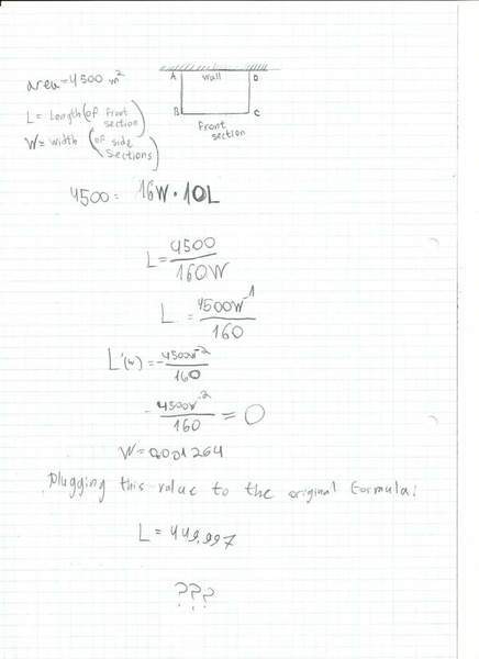

A rectangle site, ABCD, whose area is 4500 meter squared, is adjacent to a wall on one side (see drawing).
http://img820.imageshack.us/img820/4457/qcalc.jpg
They fence the front of the site, BC, and its sides, AB and CD. The price of installing a fence at the front of the site (BC) is 16 shekels per meter, and the price of installing a fence on the sides (AB and CD) is 10 shekels a meter. What should be the length of the front of the site, so the price of installig the fence would be minimal?
Calculus...
attached. I basically tried to make a formula that relates area, prices and side lengths, and then took its derivative, set it equal to zero, find a min point (found only 1 point...) and then use the score at the original formula...
here's my attempt...how far off am I?

Shalom femme
I think your area formula is wrong. Area is just WL.
then price function would be f = 16L+10W+10W
But WL = 4500
Shalom gam leha :)
Yes area is WL, but each W and L each come with their own price, so I figured it makes sense. No?
Otherwise, can you hint me at the right direction, please?
I have already written the price function. Since WL =4500 , W= 4500/L. so the price
function is
[tex]f(L) = 16L+ 20\left(\frac{4500}{L}\right) [/tex]
and you have to minimize this price function...
Oh, did you edit your post later? I only read the 1st two lines. Sorry. And thanks.
I'll go back trying to solve it now :)

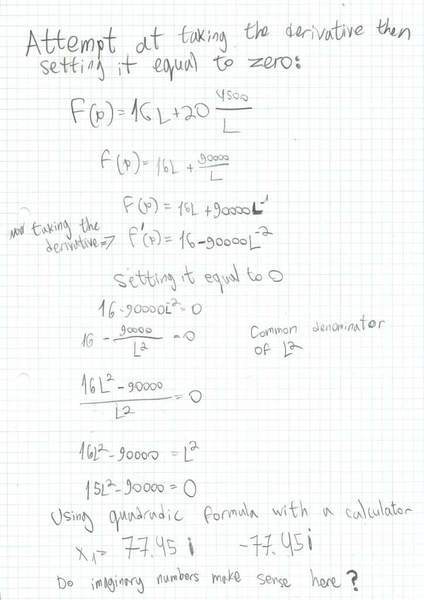

I'm getting imaginary answers when I set the derivative equal to 0...that can't be it right?

Don't bother with a common denominator.
[tex]a-\frac{b}{x^2}=0 \Rightarrow a = \frac{b}{x^2} \Rightarrow ax^2 = b[/tex]
with the condition that [itex]x \neq 0[/itex].
Also, from lower on in your work, [tex]\frac{16L^2-90000}{L^2} = 0[/tex] is not 16L2-90000=L2
femme, you are getting
[tex]16L^2 = 90000[/tex]
its simple equation. check your calculations again. no imaginary numbers here.
Excellent :) 75, and -75. Making perfect sense now.
And sorry for my algebraic mishap. I'm still knocking myself on the basics. You guys are great :)
ok... on physical grounds we reject -75 ...
Also, regarding the algebra, don't always head straight for the quadratic formula. Sometimes there are far easier methods of solution.
It's also good to verify that your answer is a minimum by taking the second derivative. (It would be bad if, in a case of multiple solutions, we picked one that maximized cost! :bugeye:)
@ Isaac - Yes, I realize -75 doesn' make sense based on physical grounds. Thank you :)
@ jhae - I checked it's a min by setting a number lower than 75 in the derivative and seeing a negative figure, then a number over 75, and seeing a positive figure. Definitely a min. Thanks :)
