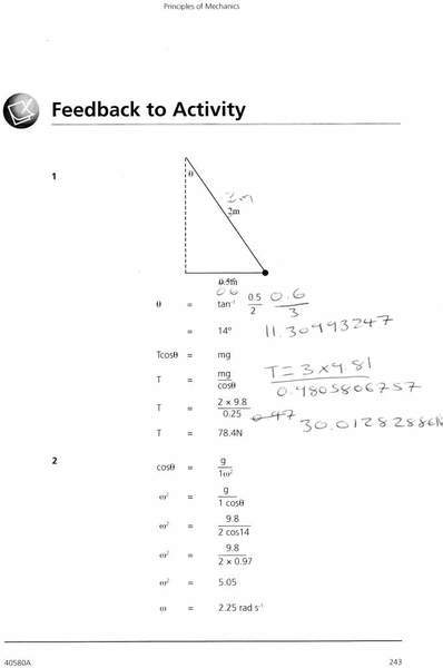

The question I am very stuck on is: Calculate the tension in a 3m string attached to a 3kg bob that is moving in horizontal circles of 0.6m radius.
All the information I have on working this out shows that tan should be used to work out the angle, I have questioned this with my tutor and he doesn’t seem to have an answer for me. (What chance have I got?)

angle = tan-1 0.6/3
angle = 11.30993247
t=3x9.81/cos11.30993247
t=29.43/0.9805806757
t=30.01282886
So the tension on the string will be 30N?

'...angle = tan-1 0.6/3...'
note that tan(angle) is NOT 0.6/3
0.6/3 = sin(angle)
Ok I'm very confused now, that's the way a simular problem just different mass and string lengh is worked out in my learning material - is that wrong then?
It all depends on which angle one takes.
A diagram of the forces is very important in a problem like this.

I have attached an example of the same question with different figures (notice the mistake cos14 is not 0.25?) I have also used this example to work out my problem and have written it to the side.
Would you mind taking a look at this?

I always start with a diagram of the forces acting so that I try to understand how the equations are obtained.
  • diag with forces.pdf
Thats great.
So I now have
[itex]\theta[/itex] = sin-1 06/3
[itex]\theta[/itex] = 11.53695903
t = mg/cos[itex]\theta[/itex]
t = 3x9.81/0.9797958971
t = 30.03686797N
That definitely clears up everything, Thankyou very much for your help.
