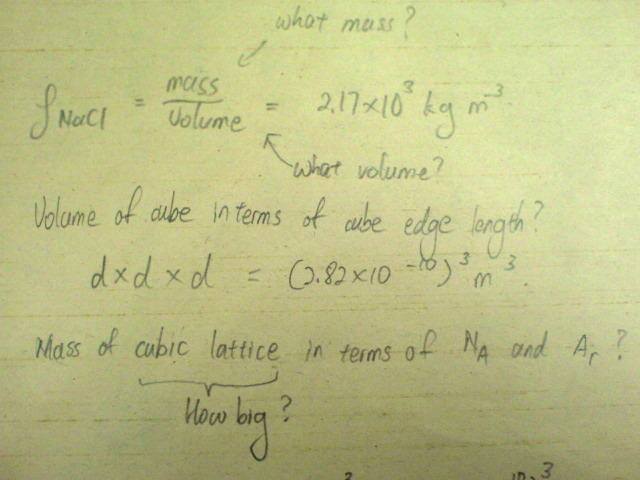

(i) Okay I really don't know what to do over here. I can't compare the ratio of the cubic volume of NaCl with that of 12C, and neither can I compare the number of atoms of NaCl in a volume of 24dm3 or 22.4. Comparing the mass doesn't help either. Can anyone please give me some pointers on this? Thank you!
For (1), density is given by
[tex]\rho = \frac{mass}{volume}[/tex]
What is the mass of the cubic lattice in terms of the Avogadro's number and molar masses? What is the volume of the cube in terms of cube edge length? You have all the other values here except Avogadro's number, which you can calculate for.

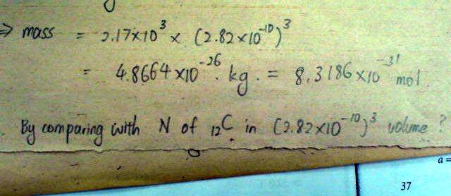

And then I'm stuck. I really don't know what "trick" am I supposed to apply here. Please help? Perhaps with a partial solution? Thank you very much!
Okay, so you have the mass of the cubic cell. This mass you got is the mass of 4 Na atoms and 4 Cl atoms. And one mole of NaCl has Avogadro number of Na and Cl atoms each. And you are given the masses of sodium and chlorine. Can you find the mass of one atom each of Na and Cl? So then you will have mass of 1 NaCl molecule in terms of Avogadro number, and the actual mass of 4NaCl molecules...Do you see a way to find NA now? :smile:
