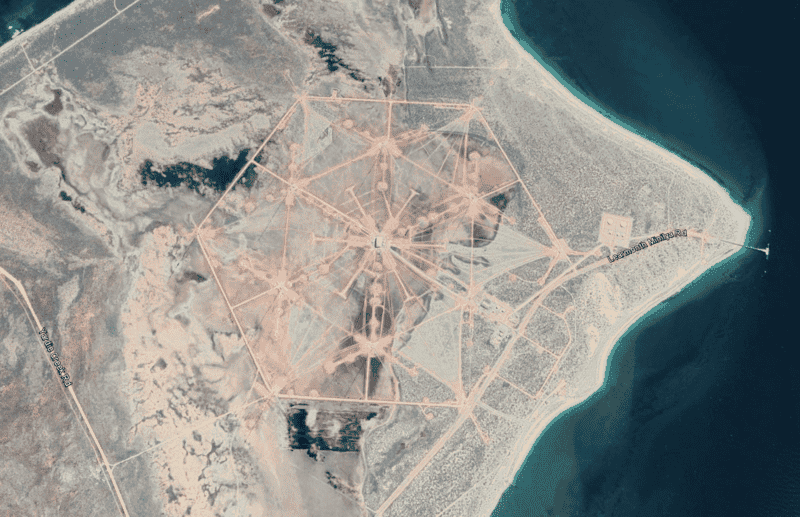

less than the 1MW ... probably more in the order of 100 kW or lessThe transmitter site from Google Earth
Actually, I plan to be over there in a few years time for an eclipse of the sunDave

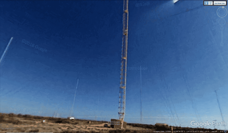

some of the metal masts
