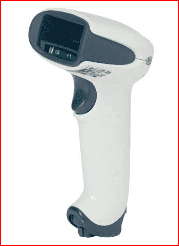

I have a need for a hand-held scanner to be able to read a MAC ID displayed on a monitor. The MAC IDs are sent to my application via a network, and I need to automatically read each MAC ID into a different application. For various reasons (Linux versus Windows applications running on different computers), it would be easiest if I could just use a hand-held scanner to capture the MAC ID into an application.
Has anybody seen Optical Character Recognition (OCR) in a simple hand-held scanner device? I guess I could write my own application based on a cell phone camera or similar, but if such an OCR application exists already for 2-D barcode scanner wands, that would be the quickest way to solve this problem. Thanks.

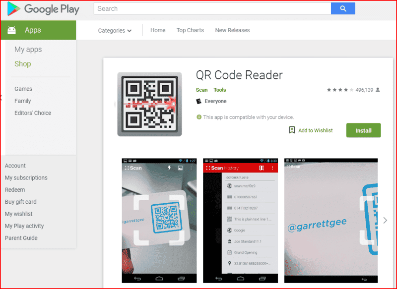

I am pretty sure I saw an Android app for that, capable of scanning the code and transferring it to the computer.

Do you mean an app for scanning a barcode or QR code? I use the Android app "QR and Barcode Scanner" for that, and it works okay. But this current requirement is different (recognizing characters and sending them over USB as a text stream).
https://play.google.com/store/apps/details?id=me.scan.android.client&hl=en_US

Sorry, missed the part about the ID being text :frown:
There are OCR apps, but no idea if they can be used to send the ocr-ed text to the computer.
