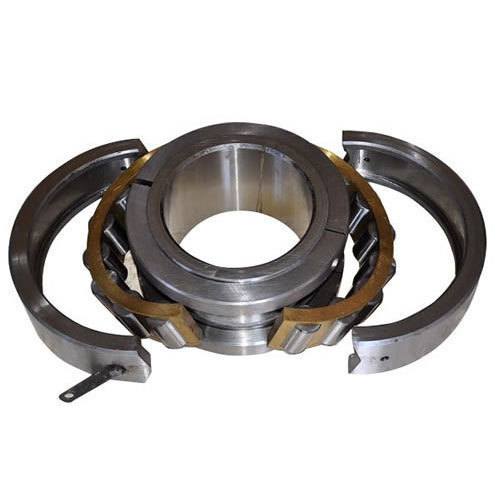

Rolling element bearings are difficult to use in an IC engine unless you use a built-up crank assembly. This is not often done. There is little point to eliminating oil on the cylinder walls if it is still needed on the crank and connecting rod bearings.
Split bearings is a thing.
So you can run roller or ball bearings on a single piece crankshaft.
Likes jack action

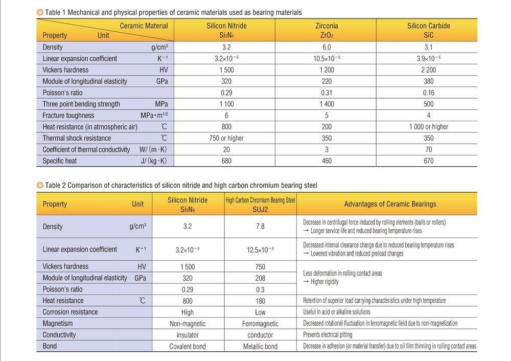

Interesting information copied from a catalog produced by a Japanese manufacturer of ceramic bearings, who also shows applications of this type of bearings for cars, trucks and motorcycles (page 15):
https://koyo.jtekt.co.jp/en/assets/file/pdf/catb1013ex.pdf

The catalog that I have posted above only shows applcations of ceramic bearings in turbo chargers and some other parts of vehicles, where lubrication conditions are marginal.
I know that, in industrial applcations, they are extensively used for high rpm's turbines and where electrical isolation is needed or where pitting of metal bearings is frequent.
