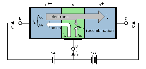

That's my take on this: the Vbe voltage between base and emitter controls how much current goes through the collector and emitter, and the transistor is built such way that the Vbe voltage causes a very small current between base and emitter. Therefore, the final effect is that a small current in the base causes a big current in the collector and emitter, the ratio of which is what is what they call forward gain (βf = Ic / Ib ).
The tricky part is the first paragraph above... why should Vbe control how much current goes through Ic? When people explain that, they usually give a pretty picture like
I think the actual effect is quite complicated, and it takes someone smarter than me to say they truly understand it, but this is how I made peace with this: in the diagram above (of a NPN transistor), EB junction is directly polarized, right? So plenty of electrons are emitted from the emitter, pulled in by the higher voltage in Vb (electrons like to go to higher voltages).
But, because the base is thin, only a few recombine with the base current, and the majority end up collected by the collector instead (as it has an even higher voltage than the base). So, as Vbe increases, Ibe increases a little bit, and Ic and Ie increase a lot. So it seems like Ic is controlled by Ib. We then call that apparent effect that Ic is controlled by Ib, as being the forward gain of the thingie.
That's how a see it, at least. I'm sure some quantum physicist is snickering at my explanation, but that's how I made peace with it :)
