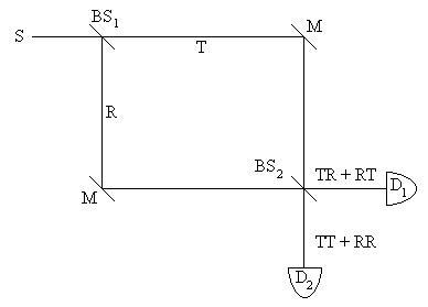

I read that if we take the classic spilt beam interference experiment like this:
and send photons one at a time, then if we mount the mirrors(M) on sensitive devices that detect the reflection of a photon the interference pattern is destroyed. This destruction of the interference pattern due to the potential to determine "which way" information occurs even if the the mirror deflection devices are not connected to any counting or other recording devices. The mere interaction and potential to record which way" information is sufficient to collapse the probability function. Personally (although I might be wrong) an "observation" of a quantum particle is any interaction between the particle and its surroundings that causes a physical change that could in principle be detected by a human, even if it is not. "Observation" is any physical interaction between the quantum particle and the (coherent?) environment and does not have to include a human observer. That makes the phrase "observation causes collapse" a bit misleading. I think "interaction causes collapse" is a bit more accurate. Observation necessarily involves interaction but not vice versa.
P.S. Bear in mind that the universe evolved for billions of years before sentient observers evolved and presumably quantum principles worked just fine even back then.
i guess...any interaction that causes a change in phase...i.e. from coherent to de-coherent...
there is degree of de-coherency as well. if they are in same phase (i.e. coherent) the interference pattern is clear...as we change the phase slowly the interference pattern gets murkier/muddier
But reflection from a mirror is an interaction, isn't it? It's just that the effect on the mirror isn't large enough to create a record of what just happened. So I think it's more accurate to say that an observation is a special kind of interaction, the kind that produces a record of the result (a record that for all practical purposes can be treated classically).
Some very quick questions. In the diagram, what is the purpose of putting the beam splitter at BS2, and what exactly do the labels "TR+RT" and "TT+RR" signify. Is there a non-interference pattern at both detectors, or is the data combined?
Dumb questions I know. Perhaps if there is a description of the experiment at Wikipedia I could get the details there. Does this experiment have a name that I could Google?
Thanks
P.S. I realize that TR+RT and TT+RR refers to the paths of the particles, but why are they in that combination?
T=transmitted
R=reflected
TR+RT = "this beam consists of a) photons that were transmitted at BS1 and reflected at BS2, and b) photons that were reflected at BS1 and transmitted at BS2".
Without BS2, D1 would only detect photons that were reflected at BS1, and D2 would only detect photons that were transmitted at BS1. BS2 recombines the beams, making it impossible to tell if an individual photon that's detected at either D1 or D2 was transmitted or reflected at BS1.
BS2 also ensures that by carefully adjusting the lengths of the T and R paths, we can choose what percentage of the total number of photons will end up at D1.
yuiop, I have been doing my best to find a reference of some kind to the experiment you describe, but I guess that my Googling skills just aren't up to the task.
I did manage to find a recent thread on this topic here at PF, but no reference to the experiment having actually been carried out.
https://www.physicsforums.com/showthread.php?t=589870
If you have a source reference I would greatly appreciate it.
Thanks
Thanks
I am afraid I do not have a reference to an actual Mach–Zehnder interferometer experiment that includes mirrors that can actually detect the the reflection of a single photon. As far as know it is just a thought experiment and the prediction is just hypothetical. It is in some ways similar to the quantum bomb detector experiment, which I think you would find interesting to read up on. The physicsforums discussion on the subject that you found seems to fairly good and worth a read.
