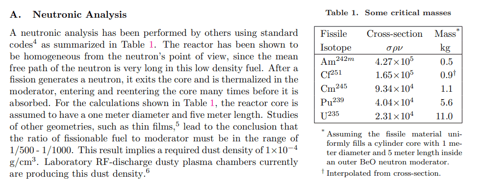

I stand corrected, I followed the NASA link several layers deep and I found this.
http://www.rbsp.info/rbs/PDF/aiaa05.pdf
By the way, this description says that it is for a homogeneous thermal reactor, not a fast reactor.

The NASA study quoted above uses a dusty plasma, and has two designs, one with a critical mass of Pu, and one with U238.
Where do you see the U-238? The only specific fuel I see mentioned is Pu-239. Which, btw, has a higher fission cross section than U-235 does, so if the designers think they need a moderator for Pu-239, they certainly would think they need a moderator for U-235.
