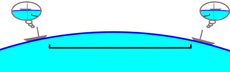

Looking out the window on recent flights I have given some thought to the implications of the fact the bodies of water we see are never actually flat, anywhere, at any size.
The earth beneath the bodies of water on its surface takes on the shape of a sphere of course, and one could say that water resting upon it must conform to its shape.
But that is not fully the correct explanation, is it? If one were to envision an enormous, flat bottomed, shallow pan, on the order of scale of scores of miles wide, and a couple of miles deep, and this gigantic flat pan of thin steel is placed in the middle of the ocean and filled with water, would the water in this gigantic pan take on the curved contour of the ocean surrounding it?
In other words, does it matter that the top and bottom of the gigantic pan is perfectly flat, or is going to fill up such that it creates the same domed “over the horizon” feature of the adjacent water all around it? I could also intuit that with a big enough pan, thousands of miles wide, its sides are further from the source of gravity than its center, so gravity is stronger in its closer center, depressing that water and raising the waterline along the wall of the pan.
If the pan were filled such that its rim is flush with the surface of the ocean, and the water had NOT formed a dome, then a passerby in a small craft would, on the edge of the pan, literally be looking at water that appears to slope down toward the middle of that pan, but has no impetus to try to move in the direction it is sloping. To me, this is nearly inconceivable. It would mean that if the pan were slightly lowered, water would rush in, even though it was already level with the pan before it was lowered, quite disturbing to think about.
So, which is correct, flat, convex or concave? Is every glass of water by analogy, domed by reason of the effects of gravity at the same curvature of the earth, or the opposite, or flat? Let’s ignore surface tension for the time being. Does gravity therefore allow, or perhaps require that a cup, pool or anything else that is open, to hold a different volume of water that what its dimensions suggest, and what is the shape of the surface at that opening as a result of gravity?

Lakes are sitting in giant flat-bottomed pans, up to tens or hundreds of miles wide. For larger pans (the oceans), gravity acting on the water and pan bends the pan into a curve.
Your intuition here is wrong about what causes the oceans to find the elevation of least gravitational potential. The easiest way to understand it, IMO, is with pressure. If the water is "piled-up" higher in one area, the pressure at the bottom is higher, and therefore the water will move away from that area, to areas of lower pressure. Water seeks to equalize pressure.
The surface of the ocean is not a dome, it is a portion of the spherical surface of the Earth. A dome would rise above that. The rest of that sounds like gibberish, though seeming to point away from the prior "logic".

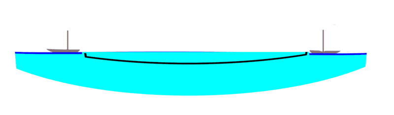

The illustration is on point. As pictured, the pan is moot because it’s below the surface, but raising it up to flush with the surface, and stopping right there at that exact spot, the pan would be holding “more” than its volumetric dimensions, and in fact even if you raised it higher, there would still be that “dome”, or would there?
It’s not meant to be a trick question. When the pan’s rim is flush with the surface, the pressure of the ocean water is no longer maintaining that dome, “above” the rim. But if water is going to be forced out of the rising pan at flush, then it’s probably going to have to be forced out of the pan before it even is flush.
Starting at flush, envisioning water rushing out of the rising pan isn’t difficult. But envisioning it rushing into the slightly lowered pan, to take a much higher position than the distance lowered from level, is.

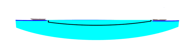

The pan's centre is closer to the centre of the Earth than its edges.
As far as the water is concerned (being that all it "knows" is gravity) the ocean's surface is flat (so that it goes nowhere on the ocean's surface) - but that the pan is an inverted dome - a sinkhole - into which it is obliged to flow.
(Let's see how good my Photoshop "Spherize" Filter Fu is...)
I have taken the original diagram and "unbent" it to illustrate what the water "sees" (and I lifted the pan to the surface).
Can you see now how the water wants to flow into the pan, which is - to it - a sinkhole?

I follow you guys, both, that the surface is flat in the sense that it is parallel with the sea floor, generally, and in all directions. I also follow that gravity demands spheres on the macro scale, be they solids, liquids or gas.
If you “slice” a flat spot on a pear with a blade, the small piece displaced is a small “dome”, which is what I’m envisioning here, above the round pan, which I’m understanding above, is the shape maintained at the surface, even though it means the depth of water over flat pan’s center will be greater than at the pan’s wall.
Also, this has if unnoticeable, general applicability across fluids in open containers I’m assuming. The surface is never truly flat.

Usually I think pictures are worth a 1,000 words. But here I think words might do a better job. It’s agreeable, right, that because the earth is a sphere, that even if we used a small wire cheese cutter to cut a “slice” off of the surface of the ocean, it would be incredibly thin but it would be “dome shaped”, an invariable trait of spheres.
The “pan” simply replicates this on a larger scale. The water over the center of a pan will be deeper as shown in Dave’s drawing, just like the “tallest” part of that “dome” will be the “middle”.
Then draw the picture I describe.
Clearly not since the conclusion you have reached obviously contradicts reality.
Water flow has nothing to do with depth, and no, "deepest" and "tallest" are not the same thing.
You seem to be actively avoiding the correct answer. Last chance. Post the diagram I asked for or directly answer the questions that followed or I will lock the thread.

Your first diagram, with ships, the pan with a uniform rim and the curvature of the earth is 100% what I would have drawn, except I might have extended the rim to be flush with with the surface.
I can’t pass a test of generating a diagram on my iPhone, and that’s why I was glad that you did. If the conversation must end because I can’t draw diagrams on my phone, even though it would be the same diagram that you did, then I suppose it is my loss for not being more technically adept, and if it gets locked, I still appreciate the input.
