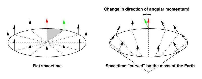

zanick said:
My original question is whether or not the gyro will be affected when installed inside an object that is following a curved path (the geodesic path) toward a massive object or orbiting a massive object like a planet. In other words, when in freefall, does the gyro always see a straight, inertial path, due to the warping of spacetime, or can it detect this change of direction relative to the object that it is heading toward or orbiting around?
Here is a description of the various effects that cause precession in orbit according to GR:
https://einstein.stanford.edu/SPACETIME/spacetime4.html
In particular the Geodetic Effect occurs even if the central mass is not spinning, and can be visualized in terms of the curved spatial geometry (Flamm's Paraboloid approximated as a cone):
Likes Dale and Sagittarius A-Star

pervect said:
An orbiting gyroscope will, as others have mentioned, have its spin axis precess relative to distant stars (often called fixed stars). As in the Gravity Probe B experiment (already mentioned), if one points the gyroscope spin axis twoards a distant "fixed" star, as the gyroscope orbits a massive body, the spin axis will shift so as not to point towards the distant "fixed" star.
I am not sure if I can interpret what you say.
you say: The spin axis will shift so as not to point towards the distant "fixed" star. so does it then drift away during 1 orbit? are you then referring to the frame dragging effect giving a very tiny drift?
But the original question was if you can detect the orbit of the satellite. So what is now the conclusion ? does the spin axis of the gyroscope follow the momentary direction of the orbit (then the conclusion is that you cannot detect the orbit with a gyroscope) or does it approximately keep pointing to the star, so then the conclusion is that you can detect the orbit with a gyroscope or at least almost completely (except for the frame dragging effect, but that is very small and costs 75.000000 dollar to detect it).
The conclusion is yes. The above posts all explain why/how it can be done.

So to be really sure: If a gyroscope orbits a planet that is not rotating or if the gyroscope moves along a non rotating star is then the conclusion that once aligned to a very far star then the gyroscope axis will keep pointing at that very far star ? (at least after 1 full orbit around a planet or in case of passing a star then from say 1 light day before the star to 1 light day at the other side of the star)
No. The spatial geometry has an angular defect, which will be detected by a sufficiently precise gyroscope.
See pages 177-179 here:
https://archive.org/details/L.EpsteinRelativityVisualizedelemTxt1994Insight/page/n189/mode/2up
See also my previous post in this thread:

Additional note regarding the below illustration from the Stanford website:
It's rather confusing to draw the arrows (gyro axis) pointing out of the 2D disc / cone mantle:
If the disc / cone mantle represent a 2D slice of the actual 3D space (orbital plane), then the shown arrows (gyro axis) point into a mere 3D embedding space of the illustration, which has no physical correspondence. But the actual gyro axis is within the physical 3D space, not pointing out of it, orthogonaly to all its axes.
Alternatively, these arrows pointing up might also be (mis)interpreted as a gyro axis being perpendicular to the orbital plane, pointing into the 3D physcial dimension. But this is even worse, because such a gyro would not change its orientation relative to the distant stars, due to the geodetic effect. See the question on page 179 in Lewis C. Epstein's book:

The diagrams that Kip Thorne uses in the video below and Lewis C. Epstein uses in his book linked above are much better, because they have the arrows (gyro axis) within the 2D spatial slice (orbital plane).
