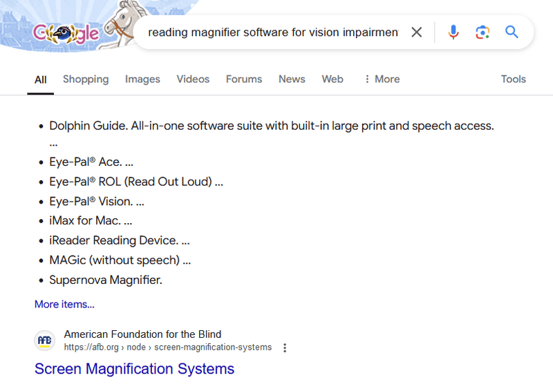

There are some pretty helpful technologies to help folks with vision issues. One of the best is a scanner/camera device that can display an enlarged image on a laptop or tablet. Maybe try a Google search similar to this:
