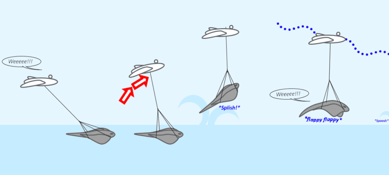

This is for a story and I want to be sure the aerodynamics are plausible. It involves a parasail (briefly) carrying its tow vehicle.
If this is on the wrong forum, apologies. This is for a science fiction story, but presumably the physics won't change. It is specifically the aeronautics behavior I'm interested in.
Executive summary: could a sufficiently-large parasailing vehicle be designed to lift its tow vehicle out of the water and carry it for a (short) time?
  • Payload: Lightweight frame with huge glider-like wings. Call it maybe a couple hundred pounds with pilot.
  • Tow-vehicle: Rather than a surface boat, it's a submarine drone (gets better purchase on the water, has more freedom of movement). Is as large and powerful as necessary to tow payload, but not so heavy as to negate any chance of glider carrying it.
  • Connected by cable of variable length, can be reeled in or eased as desired
What I'm envisioning is
- tow vehicle torpedoing just under the surface, towing the glider behind it many dozens of metres in the air (or a hundred?)
- pilot reels in cable while pitching up, so that the glider pulls forward until it is almost vertically on top on the tow vehicle (you can do this with a kite)
- pilot commands tow vehicle to breach - porpoising out of the water
- tow vehicle dangles from cable while glider carries it (on a slow descent) until tow vehicle touchs down again
This is effectively what windsurfers do:
The difference in my setup is that the airborne payload is much more than just a parachute - it's a winged frame with pilot. This raises a key question of weight ratios between tow vehicle and pilot vehicle. The tow vehicle must be powerful enough to control the pilot vehicle with ease but not so heavy as to not be carryable by the pilot vehicle.
Is it too much to hope for some amount of forward motion and some glide-ratio?
Oh. Also, full disclosure: the tow vehicle is a critter - like a giant manta ray. That shouldn't change the physics, but it does shed some clarity on my diagram:

Sure, this should be totally possible. Obviously, once the tow vehicle leaves the water, you've got a glider, so the parasail will move slightly in front of the dangling weight and will be losing altitude until the vehicle reaches water again, but with a reasonably long cord, you could certainly glide for a little while (the glide ratio won't be amazing though).
DaveC426913 said:
TL;DR Summary: This is for a story and I want to be sure the aerodynamics are plausible. It involves a parasail (briefly) carrying its tow vehicle.
Completely plausible, but you need a very powerful winch to get very far. The parasail must be designed for the weight of the pilot, the cable, the winch, and the weight of the tow critter. Parasails have glide ratios that can exceed 10:1. A parasail with cable and tow critter will be less, say about 5:1 if the tow critter behaves while in the air. The rate of descent is calculated from the airspeed and glide ratio. The scenario will be roughly as follows:
1) Tow critter tows until parasail reaches maximum altitude.
2) Tow critter breaches while winch pulls in.
3) The parasail has an airspeed and glide ratio, therefore a rate of descent.
4) The tow critter stays in the air as long as the winch pulls cable in faster than the parasail rate of descent.
5) Sploosh!

So is my intuition right? That the first step is to lift the air vehicle up-and-forward so it's almost on top of the tow beast. Otherwise, when it breaches it will just fall backward. Also, I'd want to reduce the 'penduluming' as much as possible.
I envision the cable is not let out to maximum length; the shorter the better as far as the stunt goes, although that might make the execution a fair bit more challenging.

Well that would be the trick to get the effect desired.
My current expectation is this
- the glider is nearly on top of the tow beast, both traveling horizontal
- the tow beast aggresively turns up and breaches, slackening the cable, which the glider must reel in and/or gain altitude
- there is, ideally mimimum rocking
I have not considered conditions of water or wind, and therefore have simply been assuming no conditions. Although, I can certainly see one or both being requirements if it helps the stunt, and incidentally makes for a more interesting story.
Doing this with headwind will help a lot.
I love the diagram, but I'm skeptical about the glide ratio you can achieve. Animals have a poor power to weight ratio and they swim slowly compared to the velocity you want for gliders. This isn't a big deal if you have a human with a giant sail that's driven by the wind, but here we want the animal to power everything.
A small practical matter (like it is for real world glider design) would be to ensure the cable is attached so any positive or negative pitching moments from the cable force remains controllable in all phases of flight. Usually this involves getting the attachment point close to the center of mass and use elevator (or trim) to cancel out any remaining moment.
A complicating matter could here be where to put the winching mechanism. I assume it has to be internal to the glider and the last mechanical contact point with the cable then "act" as the attachment point. In real world gliders the attachment points are on the belly for ground winch launches and in the nose for tug plane launches, and both has a pilot operated release mechanism. In your case I assume any (emergency) release mechanism has to be either releasing the cable full to let it freely spool away from the glider or some sort of guillotine cable cutter.
By the way, real world cables also include safety links that will break at a known load, but these usually sit on the cable near the attachment ring. If your design has to include both a winch and a safety link it is again not obvious where to put it. Putting it near the load (your tug vehicle) is one option but leaves the full length of the cable still attached to the glider. Perhaps the safety link can mechanically be combined with an emergency cutter so the cutter automatically engages when the cable load exceeds some limit, but its difficult to see how using purely passive mechanism (i.e. no strain-gauge measuring device and electronically triggered cutters).
Yes, the cable(s) enter the glider belly near the CoM through a funnel which is mounted on a gimbal.
Winche(s) are mounted in the center of the cockpit on top of the pedestal which is gimbaled. Note: not like a glider cockpit: like a sailboat cockpit. You sit on a bench around the pedestal and operate the various winches (which run bundled control cables).
