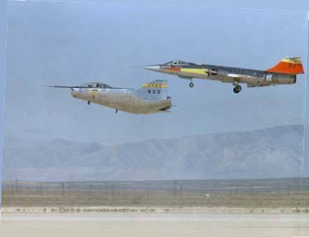

The M2-F2 (the glider version of the later rocket powered M2-F3) could glide and land reasonably well at sub-sonic speeds:
What if we direct jet streams from plane engines not horizontally but under certain angle? Could it help to increase lift? The total surface of large passenger plane body is large enough, it should generate plenty of lift if designed to do so, I think. Why it cannot be regarded as a narrow and long wing? What methods could be used to increase it lift a lot without sacrificing efficiency?
At the beginning of this video you could see how this small plane is dropped from a large one.
And it's landing with frightening speed.

It was a re-entry prototype, so it needed to be able to handle very high speeds. My guess is the landing speed was probably a bit less than the ~220 mph landing speed of the Space Shuttle, but being a small aircraft, it looks very fast.
It would also not be very aerodynamically stable given that it is just a cylindrical tube.
