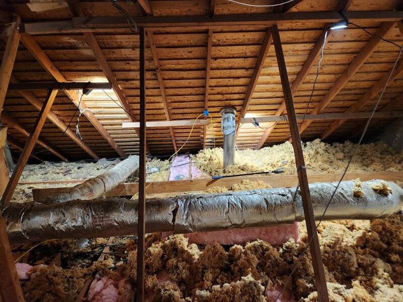

Is there an installation approach that will result in a worthwhile radiant barrier?
I am considering installing a radiant barrier in my attic to reduce the thermal load on the A/C in the summer.
The radiant barrier will only help me if it is at a lower temperature than the roof, once its at the same temp at the roof, it just becomes an equivalent radiator into the interior of my attic (equivalent to the inside surface of the roof, I mean).
So, I would need to install the barrier material such that there is as much thermal resistance with respect to conduction as possible. As the roof heats up from the radiation absorbed from the sun, I want the inside barrier to remain at the ambient temp of the attic (ambient outdoor temp at least in the early morning) and not heat up above ambient along with the roof, which is heating up above ambient and becoming a radiator.
The best approach I can think of is to attach barrier material to the roof rafters, leaving an 8" air gap (the depth of the roof rafters) between the radiant barrier and the inside of the roof. This limits heat conduction to the 2" x length surface area of the rafters where the barrier would be in contact with it. I can make it better still if I attach it with screws and put a fiberglass washer between the rafter the barrier at each screw. This is as thermally isolated as I can think to make it and still keep it a reasonable DIY project. Even that is pretty labor intensive compared to using a staple gun.
I suppose I could also just buy some mylar and lay it down on the floor of the attic, but that seems very non-robust and sometimes I do need to access the ceiling from the attic side for some kind of maintenance or project.
Roughly speaking, from June to September my attic temp will cycle between 140F and 95F every 24 hours - basically it will stay pretty hot up there. Does anyone have an instinct for whether this is any point to installing a radiant barrier as I have described, or will the barrier material just quickly heat up to the temp of the roof no matter what I do and it won't be helping me?
I feel confident in my understanding of the principles involved, but I've never done any thermal modelling and I am not confident I could get a useful result if tried to model the surface area of the rafters against barrier material and the energy from the sun and the thermal conductivity of the roof etc. I'm hoping someone has some real world experience that they can share to give me guidance here. Is this worth the bother?

I am just finishing that up. R60 seems like a LOT of insulation to me! My attic has / had 30'ish year old blown in insulation that was really flattened down and patchy. I went row by row, moving the blown-in stuff aside, laying down R30 bats (R30 is readily available because that is code for new construction where I live) and moving the now fluffed-up old blown in stuff back over the newly installed batting. I didn't dispose of the old insulation because I think it can only help things and I don't know how to legally dispose of it in any case. I'm sure there is a way, but I can't take it to the landfill. So I'm not sure what I have at the end of all that, but I'd guess about R40.
Now that I have that part done, I'm pondering the radiant barrier.

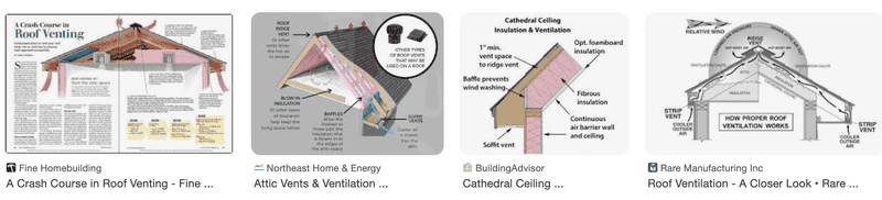

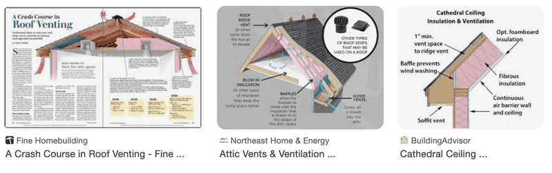

At the bottom edge of the roof there is usually a board going across which may seal the bottom. You can drill holes in this to let cooler air in from the outside. Cover the holes with screen or something to keep animals out.
The air under the roof will heat up and rise to go out the upper vents and thereby removing some of the heat.
There also some flat foam plastic that are formed to maintain a space between the insulation and the roof above it for better air flow.
from my search for"air flow under roof above insulation":
