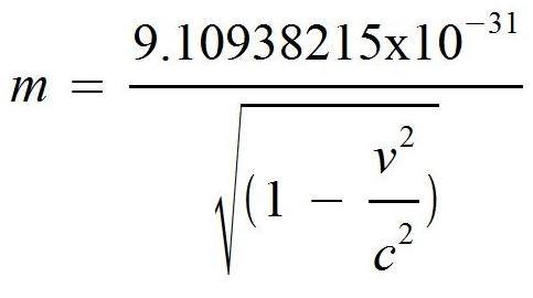

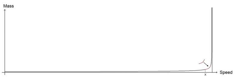

The graph we obtained is then compared to the graph of:
(Figure 2a)
*9.10938215x10-31 kg is the rest mass of an electron

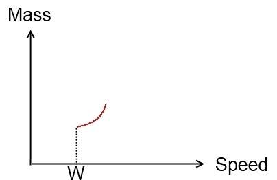

to see where it fits in. This can be achieved by comparing the change in gradients of both graphs. We then superimpose the graph we got (Figure 1) onto the graph of the equation of Figure 2a
(Figure 3)
We are now able to determine our velocity through spacetime in the direction the electron was traveling when it was measured by taking a point on the graph we obtained and subtracting the relative speed of the electron from its actual speed as reflected from the superimposed graph.
Example: In Figure 1, we measure the relative speed of the electron, W, to be say 0.8c. When we superimpose the graph, the point which contains W now reads off the new graph as X (lets say 0.83c), so we deduce that we are moving through spacetime at a velocity of 0.03c in the direction the electrons were traveling when their mass was measured.

Without reading your post, I can tell you this: the question posed in the title is misguided in that it assumes that there exists such a thing as absolute velocity. Current theory holds that there is no such thing, so it is meaningless/wrong to ask if it can be measured.
The experimental graph will always yield the graph of γm and nothing else, leading you to conclude a speed of zero every time, regardless of the spacecraft 's velocity relative to other bodies.

3. ZikZak, would the experimental graph be the same?
It would.
Note that different observers can measure different particle energys (and therefore different relativistic masses (I don't like this word)).Welcome to the concept of "relativity" ;).
