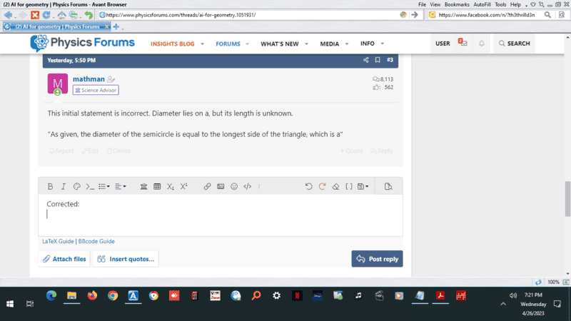

This initial statement is incorrect. Diameter lies on a, but its length is unknown.
"As given, the diameter of the semicircle is equal to the longest side of the triangle, which is a"
Corrected:
Revise to clarify.
