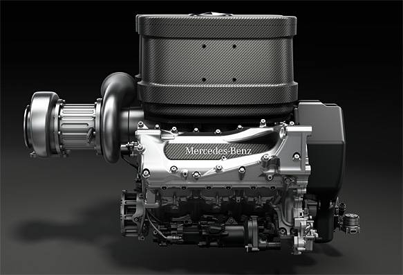

It will probably show up in F1 next year if not already.
F1 engines don't operate at low rpms, so the open manifold throttle combined with ecu cutting of fuel method keeps a high rate of exhaust flow at relatively low power settings. A few years ago, even when F1 cars were not turbo charged, this same method was used to increase exhaust flow since it was being used to assist the rear diffuser flow for increased downforce. F1 later changed the rules to not allow this, but it translates into quicker throttle response and/or it may help with the speed of the seamless shifts, so it continued to be used. Back to the current F1 cars, fuel consumption is an issue (100 kg initial fuel load and no refueling), and I don't think that using fuel to keep a turbo charger spinning is more efficient that open throttle with ecu managed fuel output.
Dude...that's an electric motor in the center section of that turbocharger.
It doesn't matter whether it's on a long haul truck as Volvo uses it or on a formula one engine as Mercedes and a few others will use next year.
Is that how the KERS (kinetic energy recovery system) or at least part of KERS is implemented on F1 race cars these days (since they now have turbo chargers)?
I think the kers system uses electric regeneration using electric motors and batteries. Another system uses a carbon fiber flywheel that spins over 100k rpm if i remember correctly and then uses it just like regenrative braking. I think there's also pnuematic and even hydraulic versions they tried as well.
There are quite a few companies that are making electric turbos. When the gas engine is just running at a constant speed on the highway or something, the turbo is spinning the generator and storing it in a battery bank. When acceleration is needed the generator works as a motor and spins the compressor. Gives u better efficiency and maximum performance. Only issues is the motor/gen is very expensive because it needs to be designed to work up to 200k rpm, it also needs a complicated expensive inverter to convert the extremely high frequency and voltage down to a usable power. It takes a bit of energy to run the inverter, which lowers the overall efficiency. The only other option is gear reduction, which also uses energy, unless u used magnetic gears.
