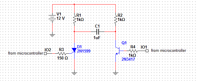

Here is what I have as a basic idea:
I don't know how to size the cap or r2 but r1 will be the load. the SCR I am experimenting with now is a S6020L and the transistor I am experimenting with is a MJH6287. It's a PNP. I meant to order an NPN version but I got em mixed up. I want high true but pnp gives me low true. Not really a problem just more of a slight inconvenience to the way I normally think of things. Anyways. Is my though process on the right track here or am I trying to do something impossible?
Basically a positive pulse from the microcontroller will turn the circuit on and a different pulse from a different pin of the microcontroller will cause the transistor to close and force current the opposite direction of the circuit for a second causing the scr holding current to go low enough therefore turning it off.
That's the basic idea, and interrupting 11 mA in a resistive load should be no problem. :smile:
But what happened to the 12V 3A motor?
Oh. I'm sorry about that. What I was trying to say is that R1 will be REPLACED with whatever load I want. All 12V loads ranging from 3A-10A or more. Idk yet. The goal is the 12V 3A motor. Sorry about the confusion. I guess I should have just put a motor schematic symbol instead of the load, flyback included. I just threw down a basic idea but yes that r1 will be REPLACED by a real load.

Just use the correct tool for the job (switching 10A @12V DC), a MOSFET.
If you're doing this to learn about SCR's and forced commutation then that's fine (though you'll need to beef up your commutation circuit to switch 10 amps), but let us know what the purpose is here.
