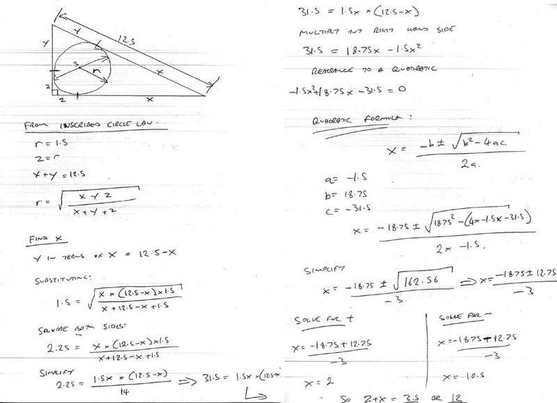

Can you work this one out?
http://i44.tinypic.com/2hxu71s.jpg
It's supposed to be a ladder resting on a barrel. We've guessed the answer will be 12ft, and proven it with CAD! What the maths behind it?

I'd of thought that there isn't enough information there to give an answer! A height would have to be known? :s
A height is known. Look carefully.
there's enough info although it can't be solved simply thru geometry and algebra. You basically have three constraints:
1) ladder top constrainted to move along y-axis (ie xtop=0 and 0<ytop<12.5)
2) ladder bottom constrainted to x-axis (ie 0<xbot<12.5 and ybot=0
3) ladder is tangent to circle
you can use the pythagorean theorem to relate xbot and ytop to the 12.5
you need an equation for constraint #3
You've obviously got its height of 3 at a depth 1.5 from the y axis. So would you have to use the equation of the circle and then differentiate it?
I've considered similar triangles but as previously mentioned there isn't the correct info there I don't think.
Sorted it, can be done with Pythagoras!

Attached the file of the workings, it almost was magic :p
Very nice, using the equation for the radius of an inscribed circle. Much simpler than solving for the angle.
