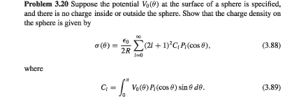

Summary:: So this is a question from Griffiths' book on electrodynamics. The topic is on electircal potential. I have come up with a solution to a problem; the solution is wrong but I cannot spot the mistake.
So here is the question:
My answer to this question is: $$\sigma( θ ) = \frac {\epsilon_0} {2R} \sum_{l=0}^\infty (2l+1)(-l-1)C_1P_l (cos \theta) \text { whereas the solution in the textbook is } \frac {\epsilon_0} {2R} \sum_{l=0}^\infty (2l+1)^{2}C_1P_l (cos \theta)$$
The step is as follows:
Potential outside the sphere is $$V_{out} =\sum_{l=0}^\infty \frac {B_l} {r^{l+1}} \ P_l (cos \theta) $$
Potential inside the sphere is equal to ##V_o(\theta)##, on the grounds that a metal conductor has a constant potential inside it.
At ##r=R##, $$V_{out} =\sum_{l=0}^\infty \frac {B_l} {R^{l+1}} \ P_l (cos \theta) = V_o(\theta) $$
Multiplying both sides by ##P_{l^{'}}cos(\theta)sin(\theta)d\theta## and integrate from ##0## to ##\pi##, we get $$\sum_{l=0}^\infty \frac {B_l} {R^{l+1}} \int_0^\pi P_{l^{'}}cos(\theta)P_{l}cos(\theta)sin(\theta)d\theta = \int_0^\pi V_o(\theta)P_{l^{'}}cos(\theta)sin(\theta)d\theta$$.
Because $$\int_0^\pi P_{l^{'}}cos(\theta)P_{l}cos(\theta)sin(\theta)d\theta =
\begin{cases}
0 & \text{if } l \neq l^{'} \\
\frac{2} {2l+1}\ & \text{if } l = l^{'}
\end{cases}
$$B_{l} = \frac {(2l+1)R^{l+1}}{2}\ \int_0^\pi V_o(\theta)P_{l^{'}}cos(\theta)sin(\theta)d\theta$$.
Therefore, $$V_{out} =\sum_{l=0}^\infty \frac {(2l+1)R^{l+1}}{2r^{l+1}}\ \int_0^\pi V_o(\theta)P_{l^{'}}cos(\theta)sin(\theta)d\theta P_{l}cos(\theta)$$
$$ =\sum_{l=0}^\infty \frac {(2l+1)R^{l+1}}{2r^{l+1}}\ C_{1} P_{l}cos(\theta)$$
The charge density at the surface is given by: $$\sigma(\theta)\ = (\frac {\partial V_{out}} {\partial r} - \frac {\partial V_{in}} {\partial r})\epsilon_o \text{ }at \text{ } r=R$$
The derivative of ##V_{in}\text{ } is \text{ }0##. Therefore, $$\sigma(\theta)\ = \epsilon_o\sum_{l=0}^\infty \frac{\partial}{\partial r}\frac {(2l+1)R^{l+1}}{2r^{l+1}}\ C_{1} P_{l}cos(\theta)$$
$$= \epsilon_o\sum_{l=0}^\infty (-l-1)\frac {(2l+1)R^{l+1}}{2r^{l+2}}\ C_{1} P_{l}cos(\theta)$$
Therefore, at ##r=R##, $$\sigma(\theta)\ = \epsilon_o\sum_{l=0}^\infty (-l-1)\frac {(2l+1)R^{l+1}}{2R^{l+2}}\ C_{1} P_{l}cos(\theta)$$
$$ = \frac {\epsilon_0} {2R} \sum_{l=0}^\infty (2l+1)(-l-1)C_1P_l (cos \theta) $$

Correct me if I'm wrong but I think ##V_o(\theta)## is not one constant but a function that varies with theta but you set it as a constant value inside the whole sphere. Also, the problem doesn't state the sphere is metal and it can't be if the potential or charge varies across the surface.

Correct me if I'm wrong but I think ##V_o(\theta)## is not one constant but a function that varies with theta but you set it as a constant value inside the whole sphere. Also, the problem doesn't state the sphere is metal and it can't be if the potential or charge varies e surface.
Thanks for your reply. May I ask where I have set ##V_o(\theta)## as a constant?
But anyway, I guess the assumption that ##\frac{\partial V_{out}}{\partial r} = 0## is invalid as it is not specifically stated that it is a metal sphere.
Where you wrote;
"Potential inside the sphere is equal to ##V_o(\theta)## , on the grounds that a metal conductor has a constant potential inside it."
It seemed like you were making that assumption.

You also asserted that
Tony Hau said:
The derivative of ##V_{in}\text{ } is \text{ }0.##
Why is that? Assume that the surface charges are pasted on the sphere. You have to write the potential inside also and apply the correct boundary conditions.
I thought it was a metal sphere. Therefore, the potential inside it should be constant and its derivative is 0. Of course, if it was not a metal sphere, I need to write down the boundary conditions to get the potential inside the sphere.

If it were a metal sphere, the potential would indeed be constant on the surface and inside. We are told that the surface of the sphere is not an equipotential because the surface potential depends on angle ##\theta##. Therefore the sphere cannot be a conductor.

Here is the correct solution from the textbook:
The general equation of charge density ##\sigma## of a charged sphere with radius ##R## is: $$\sigma(\theta)=\epsilon_o \sum_{l=0}^\infty (2l+1)A_lR^{l-1}P_l(\cos\theta)$$
The general equation for the term ##A_l## is: $$A_l=\frac{2l+1}{2R^l}\int_{0}^{\pi}V_o(\theta)P_l(\cos\theta)\sin(\theta)d\theta$$
Substituting ##A_l## into ##\sigma(\theta)##, we get:$$\sigma(\theta)=\epsilon_o\sum_{l=0}^{\infty}\frac{(2l+1)^{2}R^{l-1}}{2R^l}\int_0^{\pi}V_o(\theta)P_l(\cos\theta)\sin(\theta)d{\theta}P_l(\cos\theta)$$
$$=\frac{\epsilon_o}{2R}\sum_{l=o}^{\infty}(2l+1)^2C_lP_l(\cos\theta)$$
Likes bob012345
I think you are confusing your generals a bit. This is what I would say.
The general expressions for the potentials inside and outside are $$V_{in}(r,\theta)=\sum_{l=0}^\infty A_lr^{l}P_l(\cos\theta)~;~~~V_{out}(r,\theta)=\sum_{l=0}^\infty \frac{B_l}{r^{l+1}}P_l(\cos\theta)$$ When one applies the boundary conditions $$V_{out}(R,\theta)=V_{in}(R,\theta)=V_0(\theta)~~\text{and}~~\left. \left(\frac{\partial V_{out}}{\partial r}-\frac{\partial V_{in}}{\partial r}\right)\right|_{r=R}=-\frac{\sigma(\theta)}{\epsilon_0},$$one gets the general expression for the surface charge density
$$\sigma(\theta)=\frac{\epsilon_0}{2R}\sum_{l=0}^{\infty}(2l+1)^2C_lP_l(\cos\theta)~~\text{where}~~C_l\equiv \int_0^{\pi}V_0(\theta')P_l(\cos\theta')\sin\theta'd{\theta'}.$$
