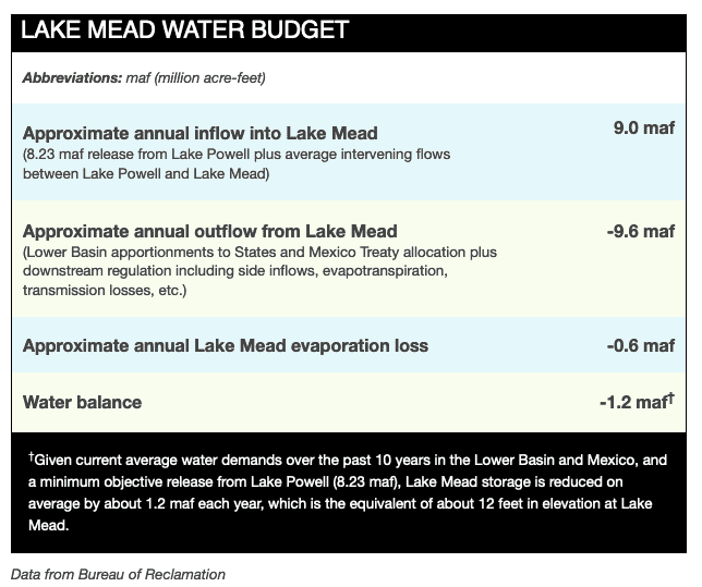

https://www.nps.gov/lake/learn/water-budget.htm
Likes Tom.G and jrmichler

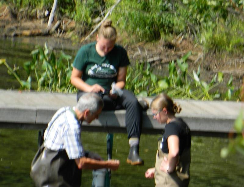

As a side note, earlier today I helped install an Onset Computer MX2001 data logger (https://www.onsetcomp.com/products/data-loggers/mx2001/ to measure lake water levels. A nonprofit is looking for better ways to measure water levels in 27 lakes than having people checking staff gauges. A photo of the installation process taken by my wife:
I lead a rough life.
Likes anorlunda and berkeman
