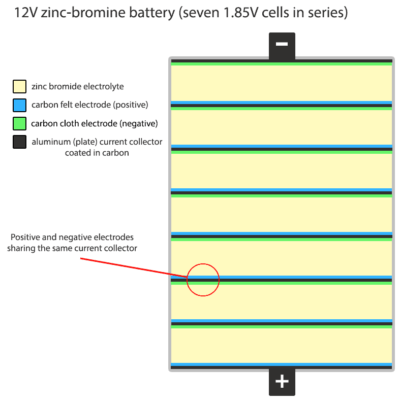

Sorry if the answer is obvious, but I was wondering if positive and negative electrodes (cells in series) can share the same current collector as depicted below? I want to create a 12V battery with cells inline in series without creating cells with individual current collectors. Note that the cell chambers are sealed.
Perhaps I don't understand the idea, but it sounds like an attempt at short circuiting cells.
I see a simple set of batteries in series
Likes Rich76
It's designed to be membrane free. The corrosive bromine at the surface of the positive carbon felt dissolves zinc dendrites forming from the negative electrode back into the electrolyte faster than they can build, given the appropriate charge current.
Yes. The cells share the same aluminium current collector (coated in carbon). Attached on one side of the current collector is the negative carbon cloth, and attached on the other side is the positive carbon felt. Is that okay?
I forgot to mention that the battery case is plastic (HDPE).
OK, "electrodes sharing current collector" was a bit ambiguous, I wasn't sure if you mean "connecting all current collectors together" or "current collector attached to anode on one side and cathode on the other side".
In the latter case these are just - like BvU wrote - batteries in series. You have to connect electrodes, whether you do it with an external wire or by using common sheet of metal doesn't matter.
