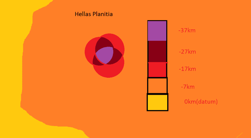

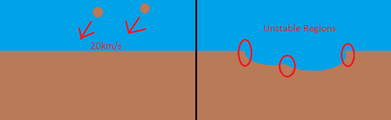

TL;DR Summary: Can comets either one or many create simultaneously overlapping impact craters for higher air pressures to breed algae and plant life as a micro climate?
Is there a depth limit to crater creation on a planet? Let’s say Mars for a depth of 30km can it be done? Assuming the projectile is an icy comet. And we have the option to use more than one at whatever time interval. Also sequential and simultaneous clusters are an option too and we can give each rock angular momentum(spin).
Scale height of Mars is 11.1km and according to my calculations from -7km elevation on Mars a -37km should yield 0.7bars. Since trees can survive on mountains with similar pressures and it’s within the Armstrong limit I am thinking a win win scenario if a planet killer was deflected from Earth and toward Mars as it will also carry water ice to the bottom of the new Martian crater as liquid water (it can stay liquid since there it’s below the Armstrong limit) for plant and algae life to breed if we so choose to plant them there. The water can also be rocket fuel and oxygen source after electrolysis in addition to drinking water. In this case soda since it will mix with CO2.
A comet such as Haileys would have sufficient ice by it self to increase Martian atmospheric material, pressure and density by 1%. While negligible with just a single comet: with repeated engineered crashes up to a hundred we could double the Martian atmospheric density and pressures gradually reducing the required depth(by half from -30km to -15km ) of future micro climate semi habitable craters to terraform Martian atmosphere slowly with photosynthesis from CO2 to O2.
Yes there is. And 30 km surely cannot be done.
Look at Hellas basin. Large impact basins on Moon, Mars et cetera do not get deeper.
The reason is the strength of rock. The rock shattered and softened by impact simply flows back and refills the basin to a roughly flat floor, with waves (single central peak or several rings).

darkdave3000 said:
the volatiles in the comet, if they can some how act as a coolant for the molten slag to harden prematurely before rising up to fill.
That just does not works like that. The 'molten slag' takes up only a small portion of the explosion (and even that'll scatter, won't participate directly in the crater formation): most of the energy goes to the gravel (creation and move).
The depth/width ratio of the crater mostly depends on the depth of penetration of the incoming object.
The depth of penetration (with a given, rocky surface) is ~ about the structural strength.
A 'dirty snowball' (comet) does not have much of that. Most likely it would leave a wide but shallow crater only.
darkdave3000 said:
Im just still struggling with the idea of the volatiles in the comet, if they can some how act as a coolant for the molten slag to harden prematurely before rising up to fill.
At 20+ km/s the entire impactor is going to be superheated and vaporized, no matter what its made out of. There will not be any 'coolant' anywhere. Also remember that the further down you go, the greater the subsequent uplifting as the material attempts to reach gravitational equilibrium. It is this that ultimately limits the depth of holes on any planetary body. What that depth is on Mars, I don't know, but 30 km is probably fairly close.
