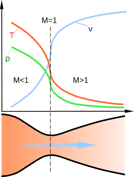

Well I see a temperature decrease as well as a pressure decrease in this diagram from Wikipedia:
The basic equation is:
[tex]c_pT_0 = \frac{V^2}{2}+c_pT[/tex]
where the following relation comes from (the one plotted on the graph):
[tex]\frac{T_0}{T} = 1+\frac{k-1}{2}M^2[/tex]
So the kinetic energy comes initially from heat (temperature). It is the isentropic condition that makes the pressure going down as well.
