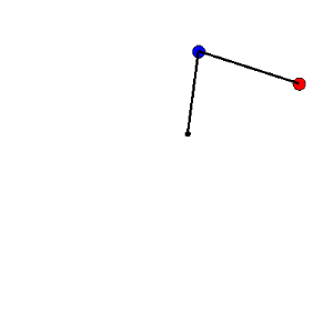

I thought a golf swing went like this:
... for our purposes the blue dot is the counterweight.
The pivot there is an annoying double-thingy because two hands.
I'm not sure about the last sentence, but yes, that graphic is correct (er; realistically, it is missing the lever arm between your spine and shoulder, but that is often omitted...). The blue dot is your left wrist and the red dot is the clubhead. Since the counterweight is right at your left wrist, all it does is increase the weight swung by your arms, which can slow down that part of your motion (your waist/shoulder pivot).
Notice that through most of the swing, the club shaft is at a right angle to your left arm, so it matters very little where you add weight as far as your shoulders are concerned. In other words, regardless of where you add weight, the impact on your torso/shoulder twist is the same. But the impact on your wrist snap is vastly different if the weight is added at your wrist vs in the shaft or at the club head.
