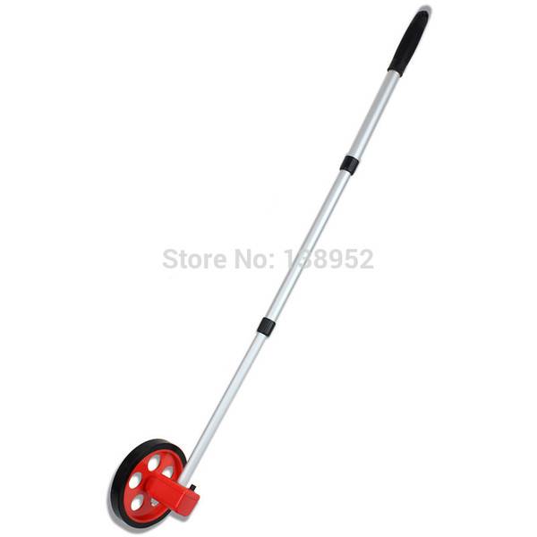

Here's a similar device:
Can someone explain to me how this device, with no electronics, measures speed and time and then performs multiplication or integration?
I've no idea how it measures time.
Like the disc in the meter, some external agency makes it rotate. In the watt meter it is electricity. Here it is someone pushing it along the road.
The little counter attached is made of reducing gears which the wheel makes to rotate.
The speed of the rotating wheel ω(t) is integrated by counting the rotations. So the counter tells you ## \int_{t=0}^{now} ω(t) \, dt ##
You do need to read the counter at the start of your trip, to find ## \int_{t=0}^{start} ω(t) \, dt ##
Then ## \int_{t=start}^{now} ω(t) \, dt = \int_{t=0}^{now} ω(t) \, dt - \int_{t=0}^{start} ω(t) \, dt ## = distance travelled, which was what was wanted.
It doesn't tell you the speed (well, any speed) but if you had a watch and recorded the time at the start and end, you could divide the distance by the difference in time to find your average (mean) speed.
If you wanted it to multiply, the only way I can think of off hand, would be to mark out a length representing one number, then walk the device along it the other number of times. Of course you want the latter number to be an integer, so you have to scale it as we had to on computers when we had only integer arithmetic available.
The answer is that it doesn't measure time.
Not by that device it isn't. The fact that the mathematical relation between speed and distance exists does not imply that any particular device is using it.
Right. It measures distance and in order to find speed, you need to separately measure time and divide.

Right: so it doesn't measure speed and time to find distance, it measures distance directly. Just like an old-style electric meter.

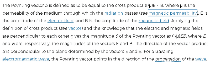

Hmmm I've been musing over this one trying to think of a mechanical analogy for Poynting vector..

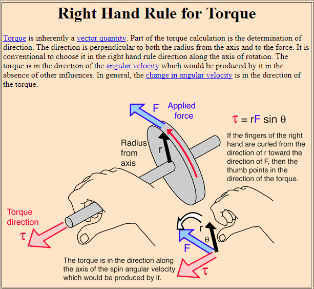

Never heard of a Poynting vector (or if I did, I forgot), but it sounds a lot like torque. How is it relevant?
sophiecentaur said:
Force, perhaps?
I was thinking more of a contraption to measure E and B fields and calculate the Poynting vector.
https://www.britannica.com/science/Poynting-vector
In high school(1963) we measured E and B fields along a slotted RF transmission line using a capacitive and an inductive pickup.
Seems now if we'd multiplied them we'd have been close. But analog multipliers back then were time division vacuum tube devices suited for sub-audio basically DC servo control.
Also, relation between permeability and permittivity gets down to the very fabric of space and my little brain gears start jumping teeth.
There's hope though. A year ago i didnt know the term Poynting Vector and now you PF guys have me thinking about them.
Hmm it does sort of resemble moment of inertia of a gyroscope, doesn't it ?
Thanks - more food for thought.
