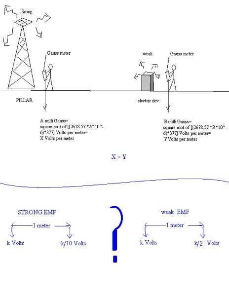

We have two difference electric fields A and B. We are standing at point W1 in field A and the potential at a point M1 which is 0.5 meter left is 10 volts while the potential at point M2, which is 0.5 meter right, is 5volts. The potential difference between M1 and M2 is 5volts and the strength in our point (W1) is 5 volts per meter. Now we are standing at point W2, in field B and the potential at a point M3 which is 0.5 meter left is 500 volts while the potential at point M4,which is 0.5 meter right, is 455volts. The potential difference between M1 and M2 is 5volts and the strength in our point (W) is 5 volts per meter. The strength of both the two fields, are the same, at the point we are standing each time. But is this right, when in field A, next to us there is a potential of 10 volts, and in field B, next to us there is a potential of 500 volts?
Can, with EF Strength, describe an EF, for example to see if the EF is harmful for our health? I mean that the limits for Electromagnetic Radiation (for them to be harmful) are in Watts per m^2, and there is a relation between Watts per meter ^2 and Volts per meter, which is V/m = square root of ((Watt/meter)^2 * 377).

thanks for reply. First, i want to know if there is something wrong in my example and if my thoughts are right, somebody who knows about electric fields, to give me an answer. I think, my example is very clear. But I really want an answer. It seems , to me , very strange, that nobody has answered, because I think it is a very simple answer, to those who knows physic.

There is nothing wrong. It's just that the value of the potential is completely arbitrary. Only the potential difference is meaningful.
In both cases you describe the same thing; a potential difference of 5 V. You can make the potentials of the two points 0 and 5 or 1 million and 1 million and 5. it's up to you to pick up the reference for potential.
Its's similar to falling from a height. It's not more dangerous to fall from 1000 m to 995 m than is to fall from 5 m to the ground (0 m).

, “AmGauss = “2678.57 * Amicro Watts per m^2 = , “2678.57 * A *10^-6Watts per m^2 = SQUARE ROOT of [(“2678.57 * A *10^-6”) * 377] Volts per meter and
BmGauss = “2678.57 * Bmicro Watts per m^2. = , “2678.57 * B *10^-6Watts per m^2 = SQUARE ROOT of [(“2678.57 * B *10^-6”) * 377] Volts per meter .
If we assume that A = 10* B, then , in the first case were I stand next to the pillar the strength in my point is SQUARE ROOT of [(“2678.57 * A *10^-6”) * 377] Volts per meter. Let’s name it “X”, thus the EMF strength is X volts per meter
And in the second case were I stand next to the “weak” device, the strength in my point is
SQUARE ROOT of [(“2678.57 * B *10^-6”) * 377] Volts per meter . or
SQUARE ROOT of [(“2678.57 * {A/10} *10^-6”) * 377] Volts per meter, and let’s name it “Y”, thus the EMF strength is Y volts per meter
What we have until now? We have that when I am standing next to a strong source , the potential difference is X volts per meter, which is bigger than Y volts per meter (which is the potential difference, in my point, when I am standing next to a weak source). This mean that in a field that produced by a strong source, the decrease of potential (when the distance from the source, change) is larger than the decrease of the potential in a source that produced from a weak source.
And my question is: Is this right ? If I am in an EMF, and measure the volts (not volts per meter, but just volts), and find that the drop of volts in distance of 1 meter is Y (from K to K/10 for example), then if I go to another EMF which is stronger, and make the same measurement, will i find that the drop of volts in distance of 1 meter will be X (from K to K/2 for example), were X>Y ?

You make it complicated (if I understand correctly what you say) by assuming that V/m measures a potential difference.
This is not so. The intensity of the electric field is measured in V/m (or N/C). The unit V/m reflects the fact that the intensity of the electric field is proportional to the gradient of the potential. If the field have the same value, the gradient will be the same.
So you have two measurements of the field which correspond to two values of the intensity. As the intensity is proportional to the square of the field, the factor of 10 in the field measurements result in a factor of 100 in the intensities.

As nasu hinted, the potential difference is measured in Volts, not in Volts per meter.

AT is correct (as he usually is). Potential difference is measured in V, not V/m.
Krakadoros said:
"milliGauss" can also be written as "Volts per meter"
No, it cannot. Gauss has SI base units of ##kg/(s^2 A)## and V/m has SI base units of ##kg~m/(s^3 A)##. They are different.

So if the strength of EF described as "X" Volt per meter, it means that there is a potential difference between two points, with 1 meter distance from each other, and is "X" Volts.(if strength is "X" Volts per meter, then between two points in a distance of 0,1 meter, the potential difference will be "X/10" Volts.)
Assuming a uniform field and measurements separated in the direction of the field, yes. Neither of these hold in general.

The word "difference" stands for "subtraction". So a potential difference is ##\Delta V = V_B-V_A##. Since both ##V_A## and ##V_B## are in volts, then ##\Delta V## must also be in volts. This is just basic and straightforward math of the simplest kind. Your informal attempted justifications are not relevant.
