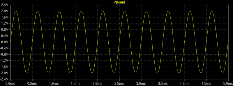

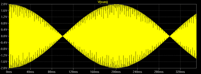

Here is the linear sum of two 1 volt sine waves 2.000 kHz and 2.005 kHz.

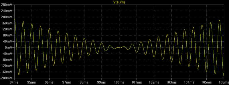

Here is the detail where they are constructive, in phase.
And here they are destructive, out of phase.
Exact cancellation to zero, can only occur if the waves have identical amplitudes.

Here is the linear sum of two sine waves 2.000 kHz and 2.005 kHz.
