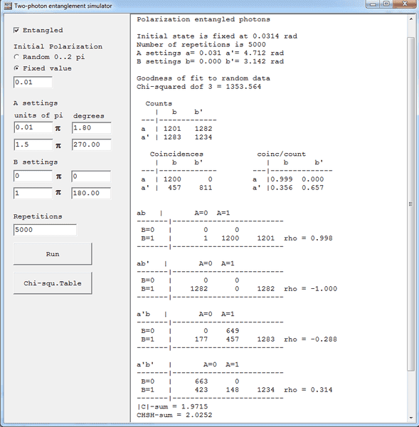

I've spent some time setting up my simulation of a photonic EPR experiment and came up with an exact joint probability distribution for the outcomes ##P_{xy}(\alpha,\beta)##.
To calculate the CHSH number we need the probability of a coincidence for each of the possible settings which becomes a correlation by doubling it and subtracting 1.This gets ##C_{ab}=2(P_{11}(a,b)+P_{00}(a,b))-1## and so on for ##ab'##, ##b'a## and ##a'b'##. The value we want is ##B=C_{ab}-C_{ab'}+C_{a'b}+C_{a'b'}##.
Using ##a=0.03412,\ a' = 3\pi/2, b=0, b'=\pi## and ##\theta_0=0.03412## gves ##B=2.0147##
This can be easily checked (please !). The value obtained here is not a statistic but an expectation and so indicates an actual violation inherent in the probabilities.
The simulation (as always) gives the same number but with statistical fluctuations.
I can provide Maxima scripts and the simulator if anyone wants them.

Summing over ##S## gives ##P_{xy}(\alpha,\beta)= \tfrac{1}{2}\left(P_{xy}(\alpha,\beta, A)+ P_{xy}(\alpha,\beta, B)\right)##

To be honest, I do not really see your point. Each photon from an entangled photon pair when viewed on its own is unpolarized on average, so you cannot cherry pick one pair of polarizations, but you have to average such that each photon viewed on its own becomes unpolarized in the ensemble average. How do you achieve that in your model?
Thanks for the reply. If you can't see the point of my post I'm sorry and it is no doubt because of my poor communication skills.
The model has achieved what it was meant to.
[Edit]
In an attempt to make my point explicitly I would like to add this.
We have here a non-local model of an idealized EPR/Aspect experiment and the joint distribution of outcomes (from photon detectors) for the setup . This distribution appears to predict the outcomes of some actual experiments including violations of the CHSH and Clauser-Holt/Eberhard inequalities. That is all. Nothing is proved or disproved. If the probabilities are a fair description then so are deductions from them.
My other hope is that someone will check the crucial calculation.

@Cthugha
I added a couple of counters to the sim code and ran a few 20000 photon reps.
THIS IS WRONG
Typically number of first photons transmitted = 10000 and of those, 5000 ( second) photons transmitted.
So I guess it will satisfy the average = 0 requirement. Later I will use the probs to confirm it formally, if possible.
THIS IS NOT
I spoke too soon. It depends on the settings and deviates from 1/2 for non-symmetric settings.
