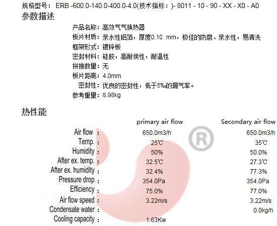

The reason I'm asking this is that I have a project to design a heat exchanger.
However , the fan spec we used has a power consumption of 145W, but customer only requires 95W per fan.
The problem is we already ordered it and we are looking for solutions.
Is it possible to lower the power consumption from 145 to 95W?

I attached the fan specifications. I will also send you the core of the heat exchanger that we use. We searched for the fan that can overcome the core's pressure drop (static pressure). It was recommended by our supplier tot meet that requirement.
For the 95W basis, actually in this system we need to have two fans, one for sucking the warm air from inside of the cabinet and also one for sucking cool air from outside cabinet. Total power consumption of two fans need to be 190W. and it will be powered by a DC 48V batteries. Currently total power consumption of two fans is 280W.

Do you have any additional details about the heat exchanger you can provide? In particular, how do you know the pressure drop that you have in the spec sheet? (354 pa).
Now, the thing that strikes me is that the airflow requirements and fan specs don't match very well:
Required Airflow: 650 m3/hr
Required Pressure: 354 pa
But on your fan curve, a pressure of 354 pa corresponds to an airflow of 950 m3/hr. So your options are:
1. Reduce the voltage to reduce the airflow.
2. Pick a different fan.
3. Make sure your spec was right.
4. Keep the extra airflow for safety factor.
However, assuming the same fan efficiency at lower speed (not guaranteed), reducing the airflow to 650 m3/hr at the same pressure won't give you the needed wattage -- you'll only drop it by the ratio of the airflows.
