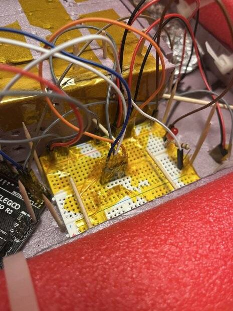

I almost forgot to post some pictures of the payload itself. Sadly, I only thought about getting pictures after its partial deconstruction. Hopefully these pictures show as I have them uploaded, and my description will make sense!
Left to right:
First picture shows our breadboard that took care of all the circuit connections. We weren't sure what to expect as far as turbulence other than "It sure seems windy up there." So we decided to secure all of the wires into the breadboard via space tape (not sure what the actual name is, but it can withstand extremely cold temperatures without losing its adhesive).

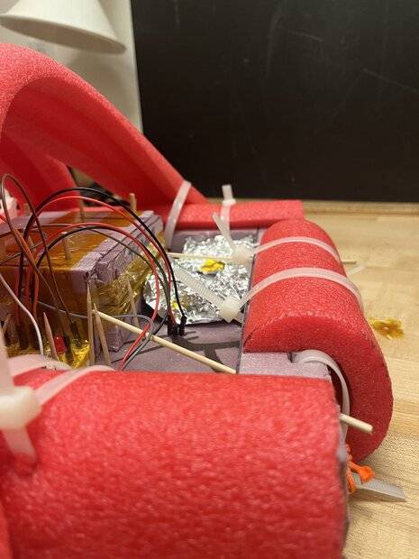

The second picture is the front view. The little house we made as to house our battery + hand warmers. Once the battery and hand warmers were inside the house, when then put two dowels into the board to block their exit. They were secured very tightly, so we didn't think they would have much force to move around with (and it didn't). We also had to attach a GoPro to the top of our house at the last second.

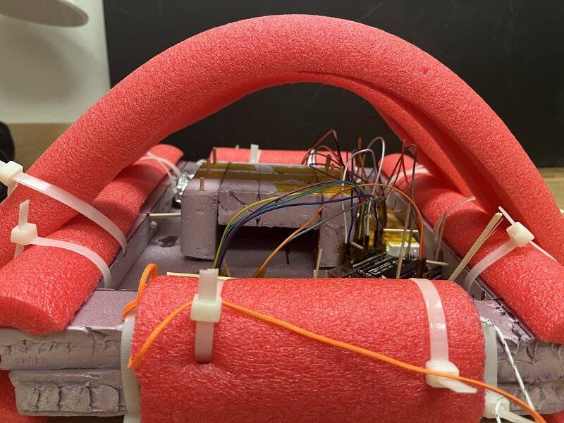

The third picture is showing a long dowel entering the payload diagonally. The purpose here was two-fold: vertically secure the Geiger counter that was underneath it and provide more stability for the house. You can also see the aluminum foil here. We had wrapped the Geiger counter in paper, then in foil (to avoid shorting it). We had tested this setup in lab, and it seemed to block out beta radiation. Unfortunately we won't get to know how effective it was.

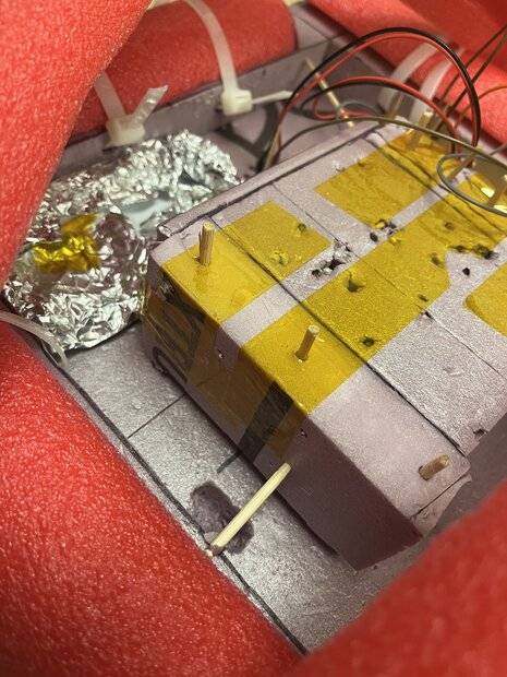

The fourth picture is the side opposite the breadboard. This shows the vertical dowels that secure the house to the payload - 3 per side. You can also see the lip of the back door of our house. There's also a hole in the base board here. This was added in the van on the way to our launch site. My professor asked me to make space for a GPS... so naturally, in the spirit of the rest of the project, I used an old pocket multi-tool and another sharp object whose name escapes me currently (long, thin cylinder that comes to a sharp point, looks like it could make great pilot holes). The dowel you see there went through the hole in the gps and secured it laterally and horizontally. We then ran the battery around the house and tucked it into the hand warmers. The battery never turned off.
