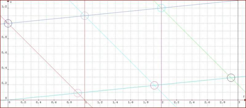

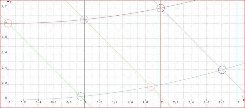

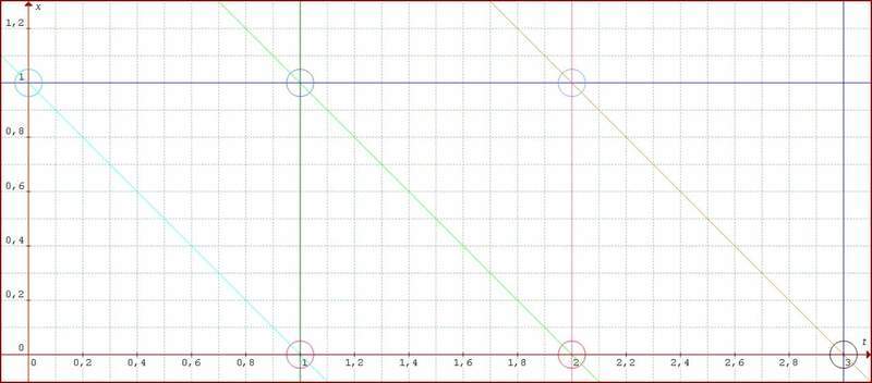

Since this thought experiment may be a little difficult to "imagine", I'll post some graphics to ease up the debate.
The graphics are some Cartesian Planes containing the following:
- Horizontal Axis (t): for Coordinate Time. Represents time passed (in seconds) since the Emission of the 1st Light Signal.
- Vertical Axis (x): for Coordinate Space. Represents altitude (1 means "c") relative to the Bottom of the Rocket.
- An Upper Rising Semi-Horizontal Line or Curve starting at <t=0, x=1>: symbolizes the position of the "Ceiling Observer" (named "Celine" from now on) as time passes.
- A Lower Rising Semi-Horizontal Line or Curve starting at <t=0, x=0>: symbolizes the position of the "Floor Observer" (named "Florence" from now on) as time passes.
- Three Falling Lines starting at { t=0 ; t=1 ; t=2 }: symbolize the Emissions of the three Light Signals traveling from Celine's Line towards Florence's Line as time passes by.
- Circles: symbolize Spacetime coordinates of the Light Signal Emissions departing from Celine and Receipts arriving at Florence.
Using these graphics, I'll examine the conditions of three cases that were described in the 4th Paragraph of the Thought Experiment Speech:

1. Rocket at Rest
- In this case the Rocket is at rest.
- Celine emits 3 Light Signals at { t=0 ; t=1 ; t=2 } .
- Each Light Signal has a flight-time-duration of "1 Second" before arriving at Florence.
- Those Light Signals correctly arrive at Florence at { t=1 ; t=2 ; t=3 } , that is, Florence measures a Δt of "1 Second" between each Light Signal arrival.
Nothing very thrilling happens here.
2. Rocket Moving at a Constant Velocity
- In this case the Rocket is moving at the constant velocity of "0.1c".
- Each Light Signal has a flight-time-duration of "10/11 Seconds" (~0.909090... Seconds) before arriving at Florence.
- Those Light Signals correctly arrive at Florence at { t~0.909090... ; t~1.909090... ; t~2.909090... } , that is, Florence measures a Δt of "1 Second" between each Light Signal arrival.
Note that even though the flight-time-duration is now smaller ("0.909090... Seconds" instead of "1 Second"), Florence doesn't notice this effect. As far as Florence is concerned, she has measured exactly "1 Second" of difference between each Light Signal arrival.
3. Rocket Accelerating at an Uniform Rate
- In this case the Rocket is constantly accelerating at "0.1c/second".
- The 1st Light Signal emitted at { t=0 } :
a) has a flight-time-duration of "~0,95445 Seconds" before arriving at Florence.
b) correctly arrives at Florence at { t~0,95445 Seconds } .
- The 2nd Light Signal emitted at { t=1 } :
a) has a flight-time-duration of "~0,87434 Seconds" before arriving at Florence.
b) correctly arrives at Florence at { t~1,87434 Seconds } .
c) Florence measures a Δt of "~0,91989 Seconds" between this signal and the previous.
- The 3rd Light Signal emitted at { t=2 } :
a) has a flight-time-duration of "~0,80625 Seconds" before arriving at Florence.
b) correctly arrives at Florence at { t~2,80625 Seconds } .
c) Florence measures a Δt of "~0,93191 Seconds" between this signal and the previous.

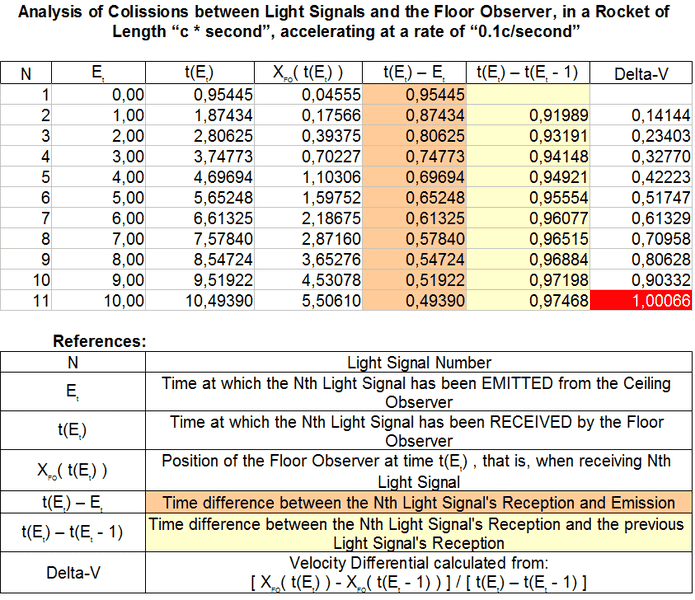

Here can be noted that Florence is now measuring a smaller time difference (Δt) between each two Light Signal Arrivals. Hence, this is one case where Florence is experiencing a "Time Dilation Effect".
In that graphic we have a table were:
- The Orange Column is the flight-time-duration of each Light Signal from Celine to Florence
- The Yellow Column is the time difference (Δt) between each Light Signal Arrival and the previous's arrival.
Note that as time passes by, the flight-time-duration decreases because Florence's Velocity is approaching to "c", and that causes Florence almost to be instantenously in the spacetime coordinate where the Events are happening (i.e., the Light Signals are being emitted), and hence there is not much space/time needed for a Light Signal to "travel through". This is the "Doppler-Effect-like" phenomenon I described earlier in this post.
Also note that as time passes by, the time difference (Δt) increases because since Florence is approaching the spacetime coordinate where the Events are happening, her "awareness of events" is resembling that of Celine, and hence Florence is experiencing the Light Signals separated by a time difference (Δt) exactly as Celine herself would experience.
Lastly, note that the difference in Velocity (Δv) measured at the 11th Light Signal Arrival is an invalid one, because there is no Light Signal that could have a velocity greater than "1c" relative to the previous signal.
