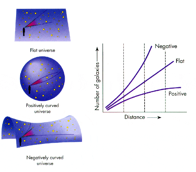

particlezoo said:
How significant could this hyperbolic curvature be without it being obvious that it exists? To take this idea to the limit, could we actually be in an universe where galaxies, or even stars, are orders of magnitude closer than we think ..
The Planck Mission measured the curvature and found it to be close to flat, ##Ω_K=0.000±0.005## which means that in principal objects could be farther or nearer than we think but only by something around 1%, probably much less, and certainly not "orders of magnitude".
My figures come from section 6.2.4 and in particular eqn(50) of the Planck 2015 Results.

particlezoo said:
The conclusion that the curvature of the universe is close to flat comes from the observation of the uniformity of the cosmic background radiation.
First, the curvature you are talking about is spatial curvature, not spacetime curvature. You should be thinking about spacetime curvature. Spatial curvature is observer-dependent; spacetime curvature is not.
Second, the uniformity of the CMBR is strong evidence for isotropy, but isotropy is not the same thing as spatial flatness; the isotropy of the CMBR, by itself, tells us nothing about the universe's spatial curvature, since there are possible models which are isotropic that have all three possible kinds of spatial curvature--positive, negative, and zero.
The conclusion that the universe is spatially flat (more precisely, that it is spatially flat as seen by comoving observers, observers who see the universe as homogeneous and isotropic--observers in different states of motion won't see the universe as spatially flat) is based on comparing the actual average density of the universe as a whole, with the "critical density" that indicates spatial flatness. Current measurements tell us that the actual density is the same as critical to within our measurement accuracy. See Ned Wright's cosmology tutorial here:
