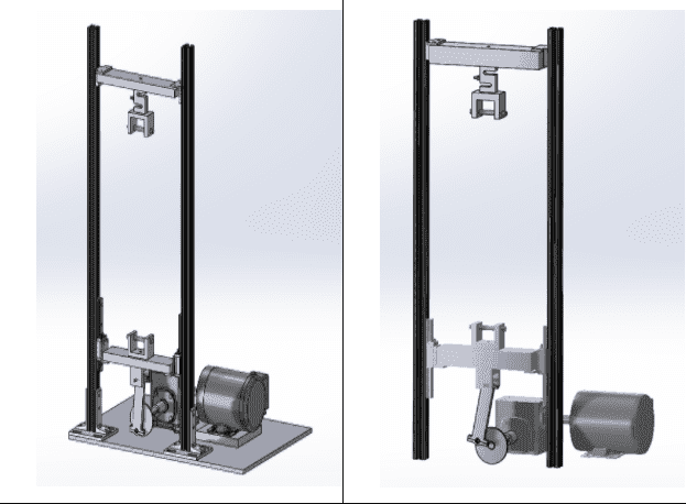

The project I am working on is to design the control system for a shock dynamometer. I am using Labview and communicating to the VFD using Modbus. The shock dyno will look a little something like this;

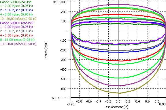

So one of the main objectives in my project is to produce a plot as seen below;
The force will be data coming from a load cell.

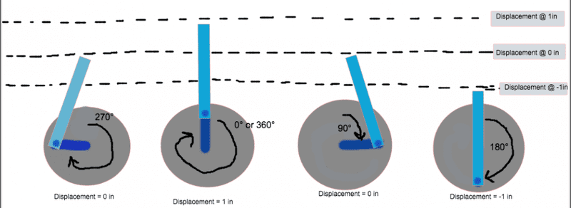

The Displacement will be the linear displacement of the shock being tested (the compression/rebound). To clarify what I mean, I have included the figure below;
My question is: Do you think I would be able to acquire the shaft position from my motor using my VFD?

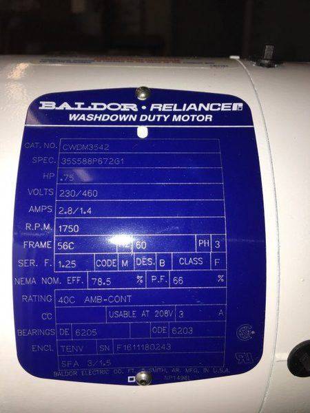

I called AutomationDirect (the manufacturer of the VFD) and asked them this question and they told me no considering the motor I am using (3 phase) is not a servo motor but I just wanted to double check with the forums to make sure. I tried reading the encoder feedback registers through Modbus and moving the shaft by hand to see if any values changed but no luck. I'm guessing I may have to implement some kind of proximity sensor in order to acquire the data for displacement. Due to the design of the dyno, I don't think I would be able to attach an external rotary encoder to the shaft of the motor. Any suggestions?
In case it helps, below is a picture of the nameplate on the motor and also the link and model of the VFD I am using.
VFD: DURApulse GS3-21P0 AC Drive

Is the main concern the shaft position or the position of the slide? There are many encoders that will report linear position.
This looks like an induction motor, so there is no telling where the rotor position is at any particular instant.
The answer you have been told from mikeholt is correct as well as in post #3 of this thread.
