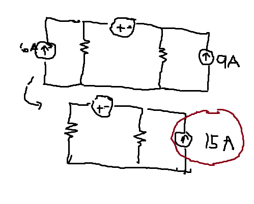

Can i add these current sources even though they are not parallel since the voltage source can be a node by applying super node? i get the same answer by using nodal analysis... but i want to know if its applicable.

Well, do they both flow into exactly the same nodes? That is, have you in any way changed the characteristics of the circuit by adding them?
Sure, they can be added that way - if only the battery between the resistors is practically perfect, without its own internal resistance. But, then, you get the calculated battery current 6A more; all the other currents and voltages being exactly the same.
Well that's my concern... if it can be considered as a single node even if there's a voltage source...
i think the question if the battery is perfect is not a problem... so can i add it that way?? thank you btw bro.
Ches, the way to answer such questions for yourself is to just try it out. Figure out all of the element currents and all of the node voltages in the circuit, then add the sources and do it again. Do any elements have a different current? Do any nodes have a different voltage?
ches18, in addition to what phinds said ask yourself what the definition of an ideal voltage and ideal current source are.
