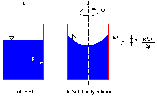

Say I have a can of water, and I am rotating it about its central axis at a constant angular rate. The water in the tank should make a 3D almost parabolic curve as it touches the the walls of the tank. Can I use Bernoulli's equation along y=0, r =0 ( starting from the minima of my parabola) to the radius (r=R) to solve a problem involving this system? Is P = (1/2) + rho*v^2 = const valid?
[/B]
I would think P = (1/2) + rho*v^2 = const may be valid because
if the fluid is rotating with the tank as a rigid body, assuming we are looking at it after it has been spun up and is rotating with constant angular rate, then it is at steady state?
The density of the fluid I am assuming is constant.
I am assuming viscosity is negligible
Are the streamlines just circles and I'm going normal to them?

Yes, the streamlines are circles, and you're going normal to them.

Once the system reaches steady state, the fluid will be rotating like a rigid body, and the angular velocity will be constant throughout the fluid. Of course the circumferential velocity will be equal to the angular velocity times the radial location.

Back to the spinning bucket with water. Assuming the angular velocity is constant, then the lowest pressure and lowest speed occurs near the center of the bucket, which would violate Bernoulli, so some other method would need to be used to find a mathematical relationship between the pressure gradient and the speed of the water.
A force balance in the radial direction would do the trick.
Rap1234: Have you learned about the Equations of Motion in cylindrical coordinates yet? If not, this can still be analyzed by doing a force balance on an element between r and r + dr, and θ and θ+dθ.
